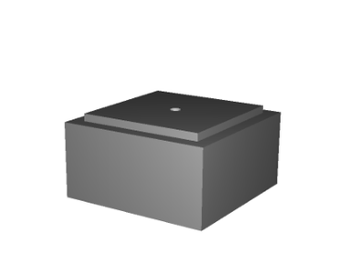

Step 2: 3D Printing
To hold the IR receivers and detectors, I made this simple 3d printed holder. Attached is the stl file so that you can print the holder as well. This was printed using Cura software and an Ultimaker 3d printer.
