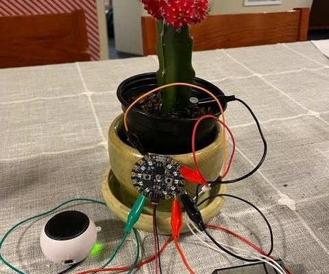

Step 4: Program in Circuit Python
I'm adding lights and sounds to my lighthouse, turned on with capacitive touch.
I got my sounds (.wav files) from free sound libraries that I'll link below:
Big Sound Bank
Free Sound
I edited them to be 22000 Hz and mono in the free Audacity software - Audacity.
I then connected my LED light strand, speaker, potentiometer, and added alligator clips (on three capacitive touch pads) to the CPB board.
Each time a touchpad is touched, a sound plays and the lights turn on and off in a certain color. The duration of the light flashes is determined by the reading on the potentiometer, in a range of 0.01 to 3 seconds.
See my code for details!

Step 5: Add Electronic Elements to the Model
Finally, put it all together!
I glued the landing and light room to the lighthouse. I left the bottom open so that you can insert the CPB board and all of the messy wires inside the main body of the lighthouse. In the back of the lighthouse, I cut out two holes for each capacitive touch pad used, so that the alligator clips linking the touch pads could be put through the holes and touched externally. The three things sticking out from underneath the lighthouse are the speaker, battery pack, and potentiometer to control the lights. I threaded the LED light strip up through the lighthouse, with the end coiled inside the light room. I left the rooftop unattached for easy access to repositioning the light strip.
This project is temporary and allows for you to take out all of the electronic pieces afterwards.
Step 6: Final Assembly and Demonstration
Put it all together, turning on the battery pack and the speaker to see your lighthouse come to life! See my video for how mine turned out.
Touch the alligator clips in the back of the lighthouse to trigger different sounds and light colors. The light duration can be changed by turning the dial of the potentiometer back and forth.
