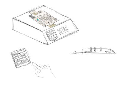

We are constructing an interactive map of the Roser ATLAS Center. The purpose of this is to assist people in finding rooms in the ATLAS building. Say you come in for the first day of class and you have a class located in room 104 of the ATLAS building, but you can't find it. Simply input "104" into the keypad and the room you're searching for lights up on the map, easily and efficiently directing you to your class.
A map of the first floor of the ATLAS building will be displayed on a piece of wood. Each room will have a clear LED that lights up red when the input is correct for that room. There will be a keypad and an LCD screen that displays the current keypad input. No lights will illuminate until the room number is inputted and is displayed on the LCD screen in whole.
The enclosure will be constructed with wood. Laser cutting will be utilized to ensure that cuts are clean and the wood looks nice. Laser cutting will also allow the map to be etched into the wood. We will then go over the etching with an art marker to darken it and make it look nice. Holes will be cut out of the control panel to allow the keypad and LCD screen merge with the enclosure. To fit the LEDs into the map, holes will be drilled into the rooms that we want to install LEDs. We will then insert the LEDS and secure them.

Step 1: Planning
We drew up how we imagined the final product to look and function. We also made a list of parts and ordered them.
