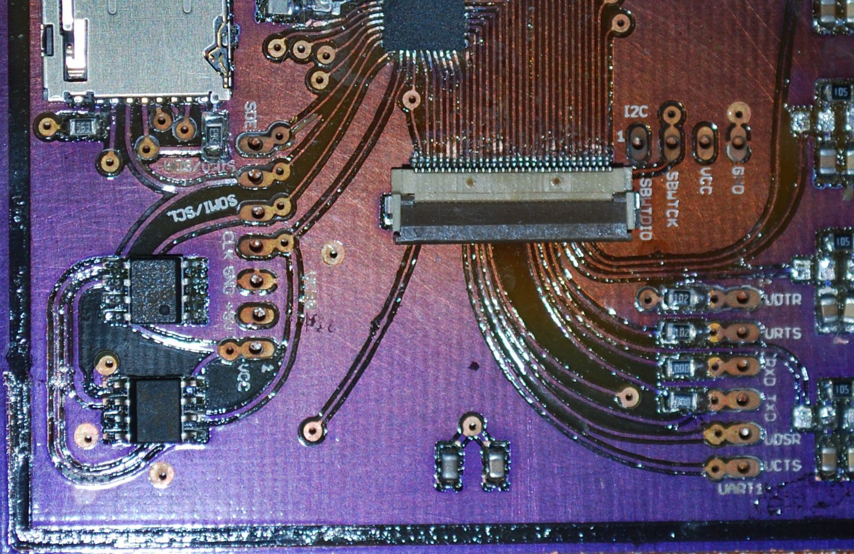

I/O pins along with numerous 5V, 3.3V and Ground pins are provided on a 34 pin edge-mounted socket tailored to work with those old floppy drive ribbon cables that you probably have buried in a box somewhere. Besides the floppy connector, a 10 pin header is available to connect in a daughterboard or motherboard configuration using SPI or I2C for communication.
