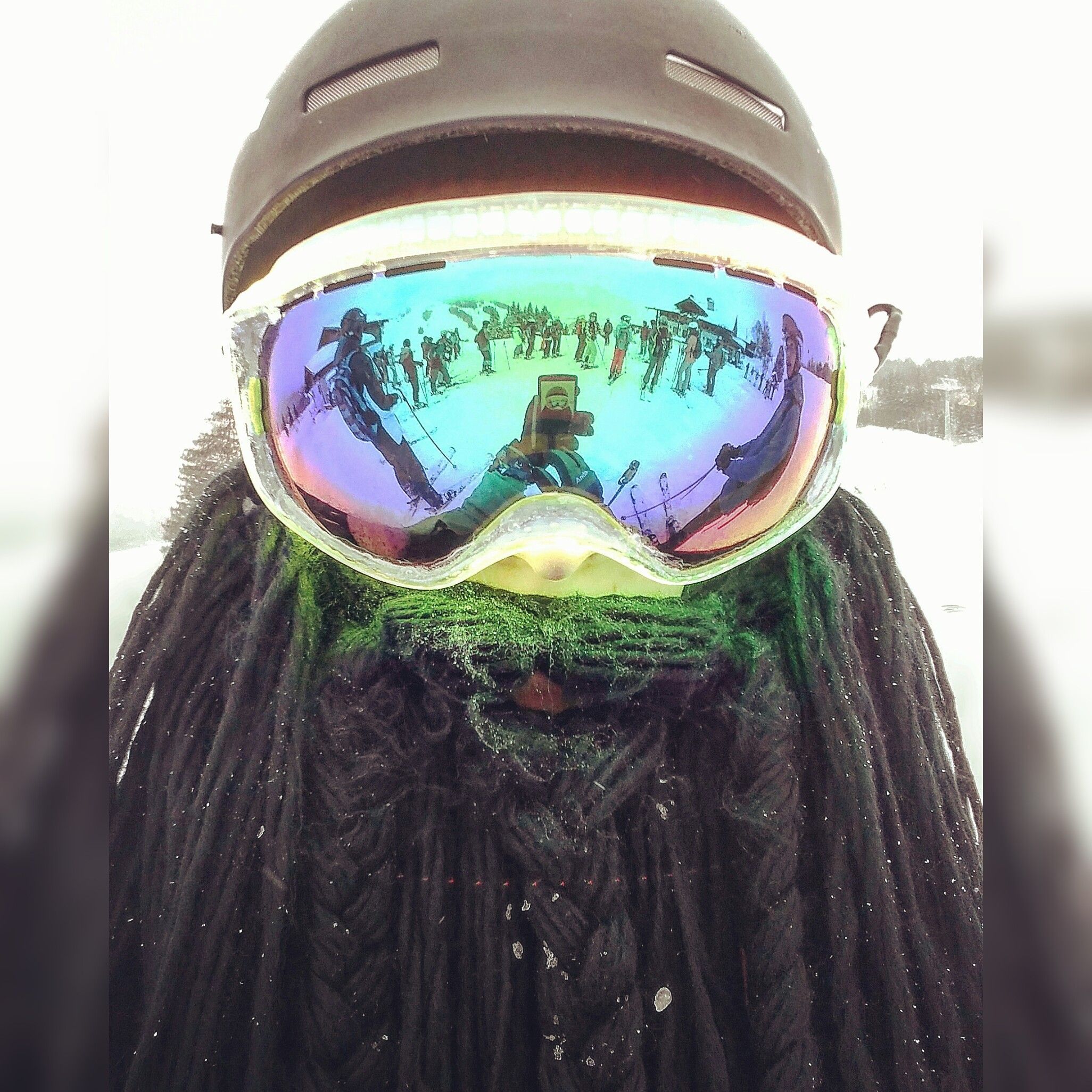

Introduction: Interactive Neopixel Skigoogle, RGB Is Life
Hello Makers,
Now that 2017 is over, some volks hope that the hype about RGB ends, but I think 2018 will need a lot more of those little pixiedust emitters. ;)
And because of that and the fact that this year it's the last my friends and I can join our school ski camp in Austria. I thought why not build the sickest Skigoogle ever, of course with Bluetooth, everything is better with Bluetooth and a Smartphone App to control it.
It is a simple but very tedious projekt, if you want to build your own you will need at least a day for building the mask, I will later explain why.
Sadly when I build this, I forgot to take some photos of the building process.
If you want to join the RGB ski club... please go on and follow my instruction,
else{ please enjoy the videos, the are very satisfying, at least some of them ;) }
Btw. it's my first tutorial... :)

Step 2: Building
Well you come this far, so let's start building!
1. If you use the same mask like me you need about 60cm of the strip ~83 Leds, better measure twice.
2. Decide on wich side you want to rout the cables back to your backpack.
3. Glue the Led's to the goggles(be aware of not to glue over the venting holes like i did)
(In order to make the strip stick to the googles I tried a lot.... after a dozen things that doesn't worked and the fact we don't have 2K glue I sanded the glass, where the Led's will sit, very intense all around and cleaned it with some nail polisher. Then applied some superglue on the first 5cm and firmly pressed the Leds on it. Then wait around 10min until the glue is dry (blowing helps) If everything is dry continue with the next 5 cm, when you reach a corner it gets a little complicated. Better ask some friends to help you holding everything in place. On the nose cave be aware of where your nose is to prevent pressure points from the Led's. )
4.ok, now you are all around, I put the end of the strip right under the beginning and cut the rest of the strip off
to make it look like a complete circle(needs some finetuning in the software)
5. Let everything dry
6. Next round of glue: Hot glue and others... Think about falling while Skiing, better to have some more layers
7. wiring: Connect the 3 pins to a cable with the Chinch plugs on the end(I sewed the cable to the headband in order to bring it safely to the back of the helmet) (I also used some acrylic to make the connection of the cable and the Led strip more stable)
8. Building the main controller:
As long as the link works.. :(
-please see the photo above- dont forget to secure everything with some glue so that nothing breaks when you are skiing
9. Upload the code after making sure everything is connected correctly!
you need to install the Neopixel libary and adjust variable of how much led's you used
10.Downloading my Android App if you want
Using the googles to get blind... no joke, look at them directly they are extremely bright
