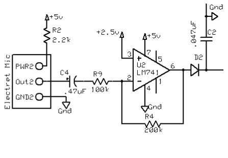

The sound sensor is a little bit harder, but not ridiculously complex. PLEASE NOTE: I have not shown a voltage divider circuit here. The 2.5V in the schematic has to be provided via something called a 'voltage divider'. It is a very, very simple circuit consisting of multiple fixed resistors, or a pot (potentiometer). Use a 50K pot for this circuit. Google 'voltage divider' and look at the wikipedia entry for help on constructing one.
EDIT 9/27/08: I ditched this sound circuit and instead used one salvaged from a sound-activated light-up pendant. The circuit here doesn't work to well; I'm not sure why, but the design is flawed ;something is not quite right. I noticed the circuit from the pendant uses an SMD LM386 op-amp. I just soldered before the resistors going to the LEDs, VCC, and GND. Then all I had to do was manipulate the values in the software a little, and presto! better working sound-responsive mood light.

Another IMPORTANT NOTE: The values for these circuits WILL differ from yours, so you WILL need to do some tweaking in the code. If you have any questions on these values, feel free to let me know.
