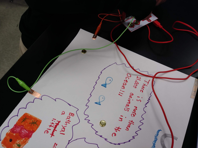

Step 3: Add Buttons and Wires
- Push a brass fastener through the poster board from front to back. Fold the legs so they are flat against the back of the poster.
- Measure the distance from the brass fastener legs to the edge of the poster. Cut a piece of copper foil tape that is long enough to cover about half an inch of one fastener leg and extends about half an inch past the edge of the poster.
- Peel off about 2 inches of the paper backing on the copper tape. Cover a half inch of the fastener leg. Continue peeling the paper off the tape as you press the tape onto the back of the poster. Wrap the last half inch around to the front of the poster.
- Label the place where the tape meets the poster edge with the name of the matching key press. This will make it easier to connect at a later time.
- Repeat steps 1-4 with your other buttons. Be sure that the copper tape strips do not touch each other or your buttons will not work as expected.
Educator Tip:
Be sure that students know not to peel the backing paper off the copper tape all at once, It will almost certainly curl up on itself and become useless. It is also important that the copper foil does not touch other tape strips or fastener legs. This will create short circuits and cause unexpected key presses.
Step 4: Connect Your Poster to Your Scratch Project
- Connect alligator clips to the connections at the edge of your poster.
- Connec the other end of each clip to the matching input on the Makey Makey.
- Connect the Makey Makey to the computer.
- Run your Scratch program
- Touch the ground point with one hand and one of the key press points with the other. Your Scratch program should run the script attached to that key press.
