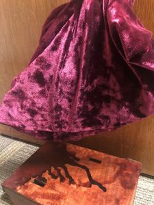

Step 9: Make a Bag for the Figures/ Scenes
Using a fabric of your choosing, place all the figures on top of it. From there, eye how much fabric you need to make a bag to contain your figures. I folded the fabric over so that when I cut, I was cutting the equivalent of all the fabric needed. I had the fabric inside out and pinned the halves together. Making sure the needle was threaded and that the bobbin was right, I put the foot down on the sewing machine to secure the fabric. From there, step on the pedal to go forward a bit. I then reversed it back by holding down the side lever. Then I went forward again. When approaching a corner of the fabric, I used a knob to place the needle down, lifted the foot, spun the fabric, and continued sewing. To finish the stich, I just reversed again and then cut the thread. It would be ideal to have a drawstring or ribbon for this. I did not have one, so it is just a simple, open fabric bag.
The fabric colors I most thought of were a sparkly black, a red (as pictured), or a velvety, deep green.
