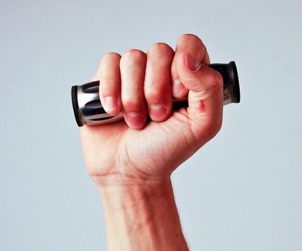

First we need to calibrate the surface we want to work on. We do this by pressing the A-button on the Wii remote and pointing the four points on the screen with the IR pen.
On the pen we have 2 switches, one for the calibration and one for use. The smallest (monostable) switch you can use to calibrate because it works like a mouseclick. The biggest (bistable) switch you can use to work with because it switches on the pen permanently.
After the calibration you can use the pen as you computer mouse but then on big the big screen. It's now possible to do all kinds of games, drawing, writing, ect. with only a pen and your projection screen.
