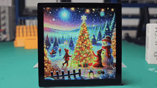

After making it, let's run it and see if it works
./snow_simulation -w 720 -h 720 -e /dev/input/event0
  1. Replace 720 with your display's resolution.
  2. Replace /dev/input/event0 with your touchscreen's input device.
Switch Backgrounds:
  1. Tap the screen to change backgrounds dynamically.

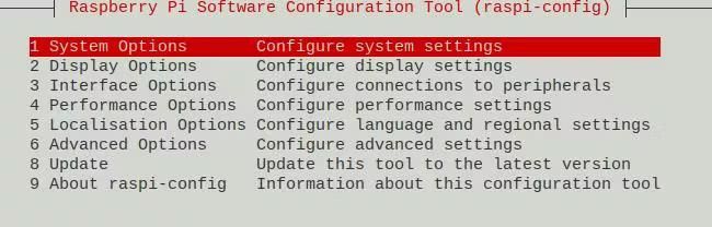

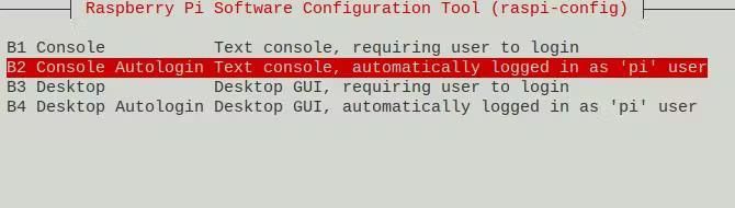

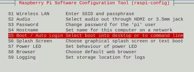

Step 6: Autostart
To autostart the program when the Raspberry PI starts or reboots, we can use our.basrc file.
Just configure the Raspberry PI OS to auto login to cli:
1. System Options > S5 Boot / Auto Login > B2 Console Autologin
Next, edit your .basrc to execute the program once you login.
