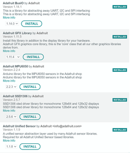

Step 2: Uploading Code to Arduino
It's important for you to download multiple libraries you can see in the image above. Add those to your arduino project libraries. I've used the code you can see underneath this text. The code will read out multiple sensors by using the pins in arduino. By reading out the values and assigning them to an int, we will be able to write all the outputs in one string and send them through the serial port to Unity. You can copy paste this into your own arduino file/project.

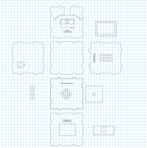

Step 4: Lasercutting Case
To make sure the casing of the project will look nice we will use a lasercutting machine. For my design I wanted to have a cube that is easy to hold so not too big for one hand. To make a vector drawing I used the program Inkscape, which can be downloaded from the internet online. In the picture above you can see the template I made I will also attach the Inkscape file itself. For laser cutting make sure you safe it as a the right file (in my case this was .dxf).
Use the right size MDF plate, 50cm, 60cm, 4mm. This has been noted in the material list.
!Only the text and camera in the picture should be engraved, the rest should be fully cut out!
Lasercut the materials. In the second photo u can see my first design. Only this one was slightly to small. Make sure you use the file attached, and the WxLxH of the box should be 11cm x 11cm x 11 cm in total.
Make sure to safe the waste materials as we will use this later on when building our arduino into the casing.

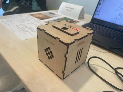

Step 5: Put the Casing Together
For this step we will glue the box partly together and install the printed plates to the box plates by using screws.
First its important you screw the printed plates to the right box side. Make sure the lightsensor is visible from the other side of the box plate, so you're sure it will catch light. Also screw the gyroscope to the back box part since this is the right placement for how the box is held. Then glue all the parts of the box together, EXCEPT the top part and the behind part. (So the one with the camera drawing and the one with the leds on top should not be glued!)
Then with the reserve waste parts we will glue 2 small plates on top of each other ( 7cm x 5cm). Once the glue is dried screw the arduino casing onto the small plate that has now a thickness of 2x4mm (8mm total). Then install the arduino in the casing. Make sure when gluing the bottom wood part with the arduino you make sure that the part where the cable needs to put in can be reached through the hole underneath the camera engraving.
Then with the 4 tiny blocks we printed we will make a system with elastics that can hold the box together while we are not trying to access the inside. Glue two of the tiny blocks on the top plate of the box (view the reference photo's) and the other 2 blocks on the bottom plate of the box (again view reference photo's).
Then glue the top part of the top plate of the box in the right place, so the gap is around the button and the leds are still visible.
After this dries you can put the top part and back part on the box and use 2 elastics to hold it together.
Now you can put all the wires in the right arduino pins, also make sure you put the sound sensor in the round hole in the middle of the other holes. If it's not a perfect fit then make sure to use wood file and vile till it fits.
Eventually it should look like the reference pictures.

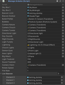

Step 6: Connecting Arduino to Unity
In this step we will send the information that arduino reads out in the serial port and have Unity read this information out. We will have to create a new Unity project, once loaded add a new script. For this we will need the following base code:
Make sure after you safe your script. To put the script on an empty object and assign a camera and rotation speed.
If you play the scene you should be able to read the values in the UI and your camera should also be able to rotate over the Y-Axis. You're able to make the camera rotate because of using the Gyroscope, the gyroscope has the function to use the Roll, Pitch Yaw. As you will be able to see in the picture above. We will only make use of the Yaw function so the player can look around and rotate in the Y axis.
Make sure you have uploaded the arduino code to your arduino, Also make sure that once you play the unity scene you have the serial port in the arduino program closed!

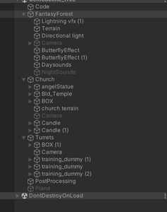

Step 7: Making Scene Interactable
You'll now be able to use the values to your liking. You can play with the buttonstate, soundvalue and lightvalues. By using tresholds you can determine when you'd like an effect to happen or not. I will give you the example on how I implemented it in my own scene and give you the code. The process will be shown in the next steps.
Step 8: Adding Multiple Views (with Camera)
I started off by building 3 different area's that each had a different camera. I used assets from the Unity assets store to distinguish them and give them each an individual feel.
I wanted each scene to have a different interactable function based on the input we give in the arduino box.

I used a lot of public objects, make sure that if you want to use the same, you assign all the objects and visual effects you made to the right public objects in the scene. You can see this in the example picture, shown above.
