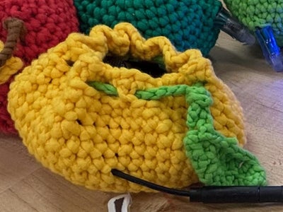

3) Fruit Pouch + Raspberry Pi Pico
Using HayHayCrochet's "simple crochet fruit drawstring pouch" pattern, I made a lemon-shaped pouch to store the pico and hide the wiring. I followed the pattern closely except for the following modifications:
Pouch:
Rounds 1-9: As-is
Rounds 10-13: Sc in each st until the end of the round
Round 14: *Sc 7, dec, *rep until the end of the round.
Rounds 16-17: Sc in each st until the end of the round
At this stage, I undid the wiring on the pico, placed it on the wrong-side of the pouch, wove in the wires, and re-secured them to the pico before continuing.
Round 18: Sl st into the first sc of the round, ch 1, sc into that same st, ch 2, sk 2 sts,*sc, ch 2, sk 2 sts, *rep until the end of the round (you should end with a ch 2).
Round 19: Sl st into the first st of the round, ch 1, sc into that same st, sc 2 in ch space you created in the previous round, *sc, sc 2 in ch space, *rep until the end of the round, sl st into first sc of the round.
Leaf drawstring: As-is

Sew the head and the body segments together. Sew the head and the first body segment to the pouch to secure it.
