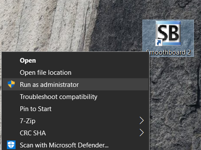

Launch Smoothboard_Setup2.exe by right click on it and choose "Run as Administrator"
Once the installation finished, run the software in Administrator mode one more time.
It may ask a license key, wait a few seconds and choose "Continue unregistered". We only need this software for the wiimote to connect.

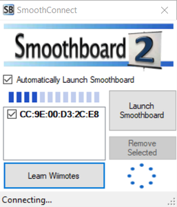

Smoothboard will try to find your Wiimote and can take a bit of time.
When it find it, click on "Launch Smoothboard".

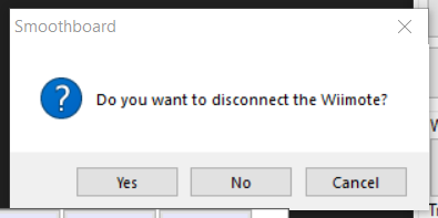

Now that Smoothboard have you Wiimote connected, you can quit it.
It will prompted you if you want to disconnect the Wiimote, choose "No".

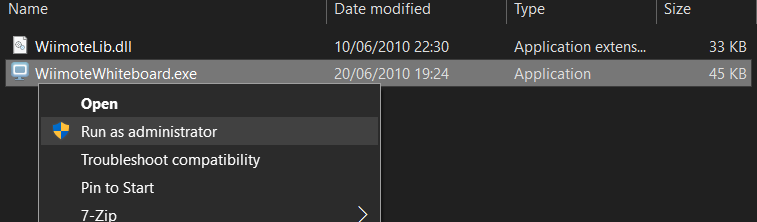

Inside the extracted files, open the WiimoteWhiteboard_12 folder and launch as Administrator the file "WiimoteWhiteboard.exe"

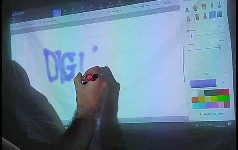

Finish your four corner calibration and voilà. You can now use your Infrared Pen as a mouse.
Try opening Paint 3D or any other drawing software to test your new Whiteboard.
Because there is always a bit of difference between where you target and what you see being drawn, it is also recommended to use a big brush as tool of drawing.
