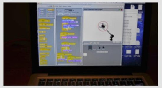

Step 12: Test Your Book's Interactions With Scratch
Open the pre-made Scratch project, found at: http://scratch.mit.edu/projects/10894151 to test your book's interactions. Remember to use your finger as the switch to activate each page.
Step 13: Watch a Video of the Interactive Book in Action
