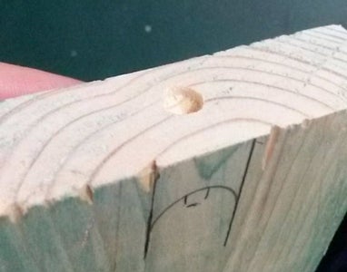

Step 1: Cutting Template

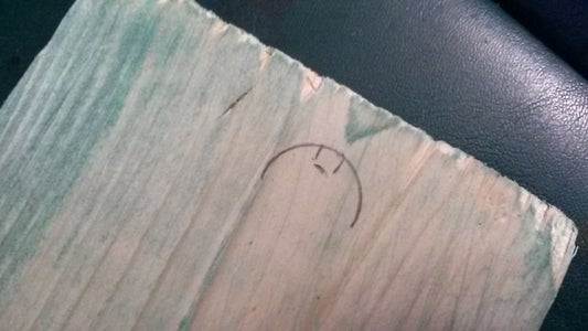

Mark the length of your bolt on the end of the wood. I used a 1/2" length/size 4-40.

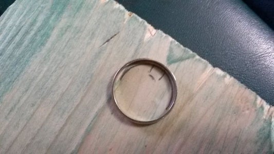

Trace the inside of a personal ring to get an appropriate curve for your finger. I traced mine just above the bottom of the bolt mark with the assumption that whatever I ultimately put under the bolt will push it up enough to keep it from bumping into my finger.
Use your ruler to draw a straight line from each edge of the curve to the end of the board.
Continue those lines onto the edge of the board.

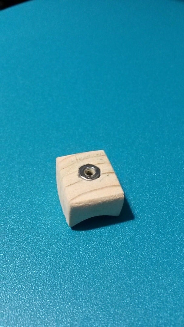

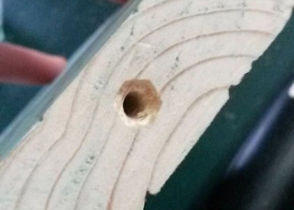

Step 2: Adding the Nut
Choose a drill bit that is slightly smaller than the nut.
Use the guidelines on the edge of the board to drill a hole in the center only as deep as the nut's thickness.
Sand the edge.
Hammer the nut into the hole.
Pop the nut back out and glue it in with E-6000 while being careful to not get glue on the threads.

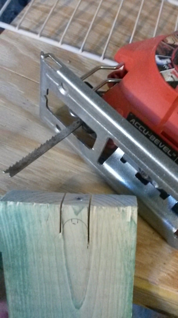

Step 3: Cut and Sand
Cut from the edge to the sides of the curve on each side.
Cut the curve.
Sand the woodblock down until it is smooth and even.

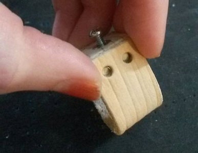

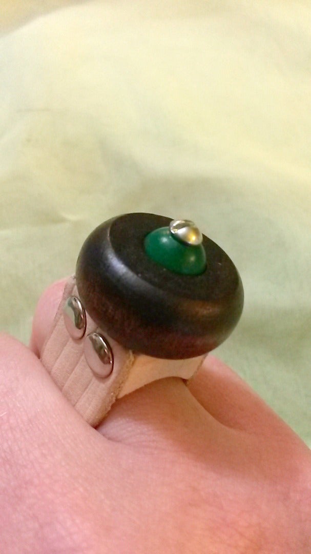

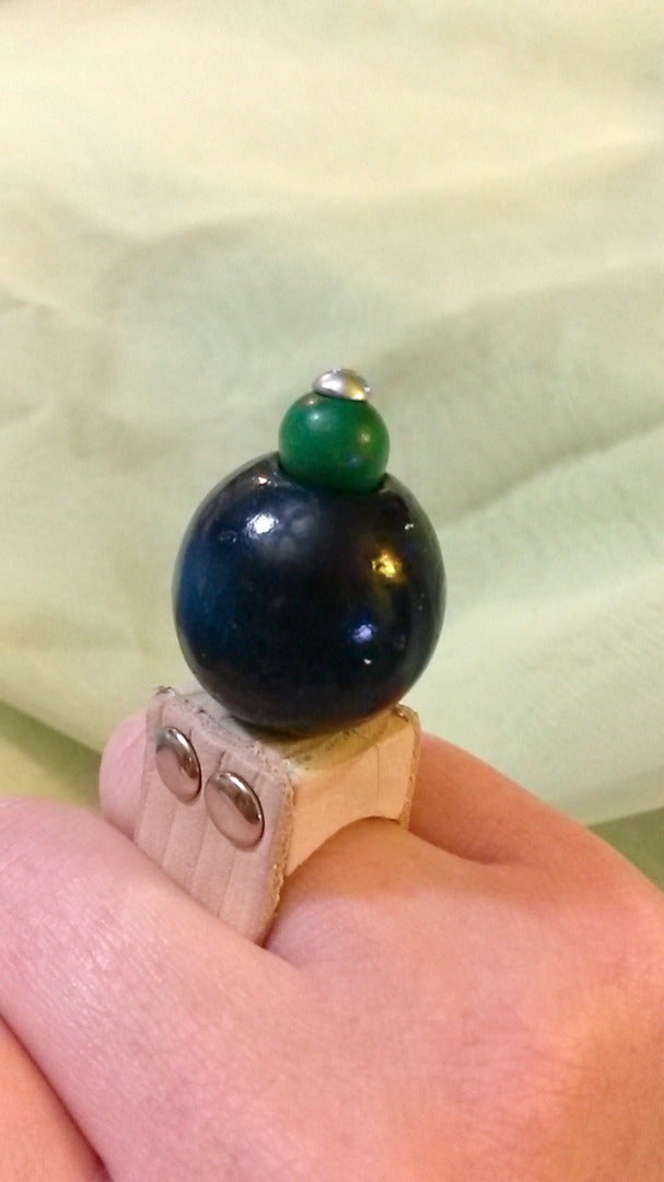

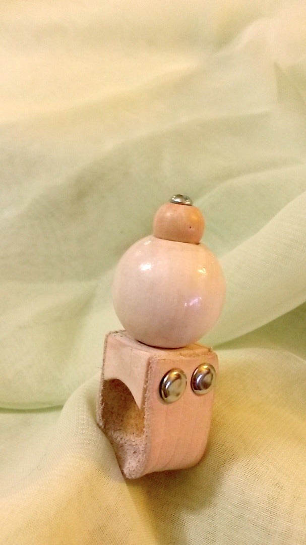

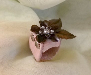

Step 8: Customize
Gather items with holes.
I also picked up some bolts of the same diameter but different lengths to accommodate larger items.
Place an item on the bolt and screw it in.
If you don't like the screw to show on top or the bolt isn't long enough, you could countersink the bolt into an item like I did with this pink wooden bead.

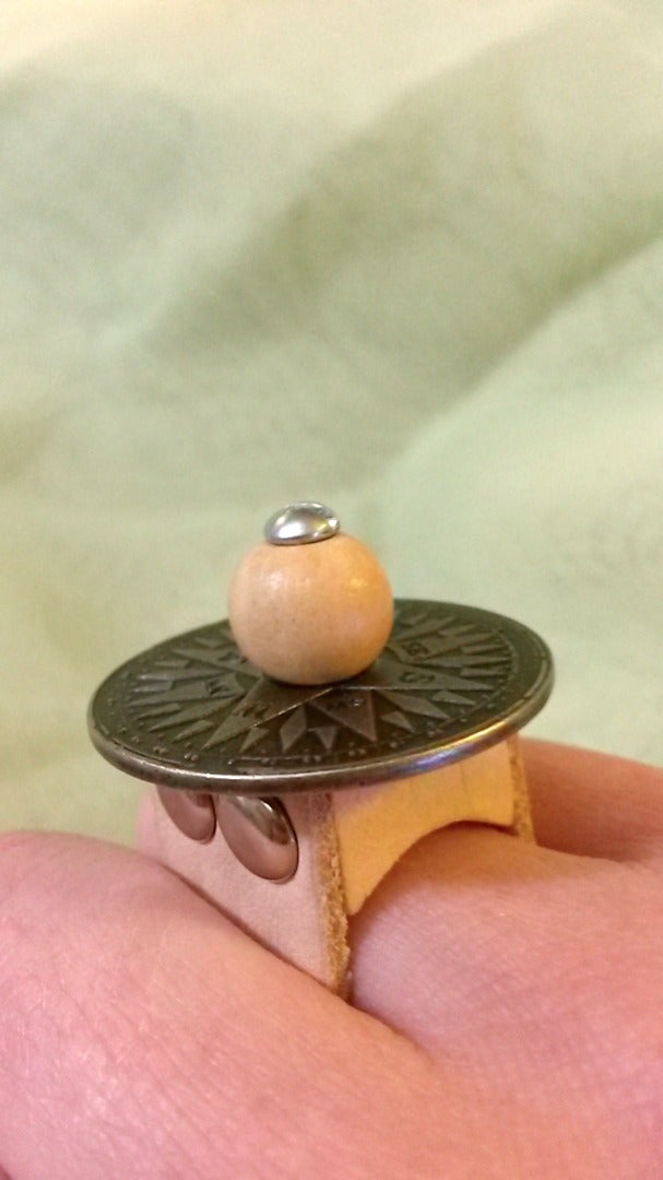

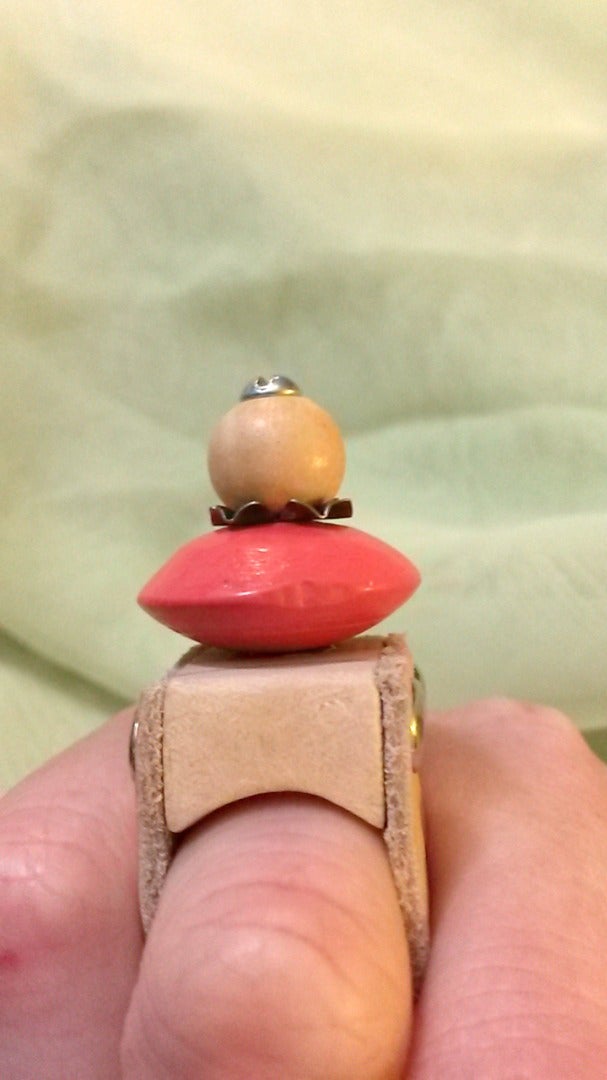

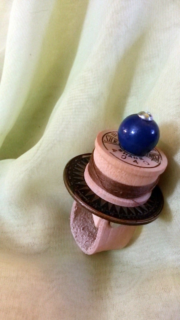

Step 9: Infinite Possibilities
Mix and match your items to fit your mood or outfit. Don't forget that you can also drill a hole in items that don't have one to add them to your ring.
I'd love to hear suggestions for items that could be added to this ring in the comments. Coins or washers could be great for example.
