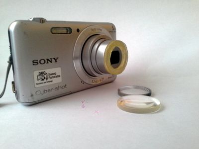

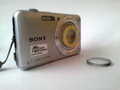

We buy car mat for mobile telephones. The mat sticks to the smooth surfaces, leaving no traces.
We cut a lense ring size.

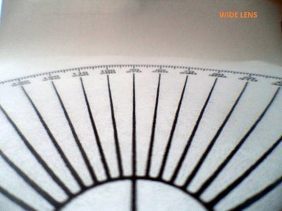

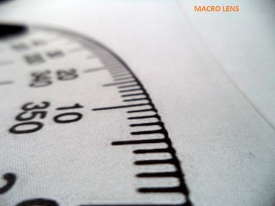

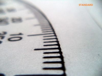

We take any lenses, which increase for macro, decrease will be with wide-angle lens. That’s all.
Standard lenses have 90 degrees, specific lens have 120-130 degrees. It becomes simply and inexpensively semi-compact camera. There are also a lot of interesting things everyone can see in this blog site http://ravvinoff.livejournal.com
