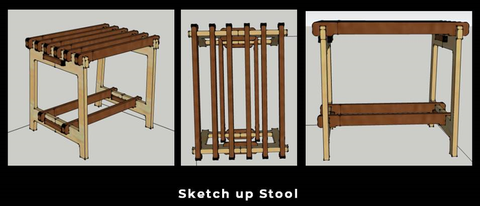

  • After drawing in AutoCAD, assemble the stool in SketchUp.

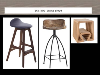

Step 3: Existing Stool Study
Before I began making the stool, I had to study existing stool designs to understand what's possible to make on the CNC machine. The CNC I was using was of 3 axis. So, the CNC - arm was limited to 'X' horizontal , 'Y' vertical and 'Z' to give depth.
Keep in mind also the floor size of the CNC. The CNC, which was used to make this stool, could'nt work beyond an area of 600mm x 900mm. So the maximum dimension of the Ply that I could use was decided by this constraint.

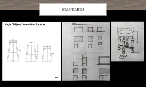

Step 4: Refer to the Time Saver Standard
Newton said, 'If I have seen farther, it is by standing on the shoulders of giants'. This means, he advanced further on the foundation left behind by his predecessors. To learn from this wise man, there is no point reinventing the wheel, which is why the architects follow their holy bible, 'The Time Saver Standard'. This book has the measurements of commonly used objects. So that the ergonomics are taken care of and you need to just design the stool following the dimensions given in the book.

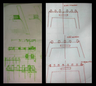

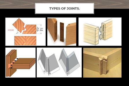

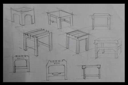

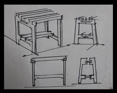

Step 5: Ideation and Joinery Study.
Once you have sketched the stool, the next step is to figure out how each part will join the other. Study different types of joinery to get a better idea.

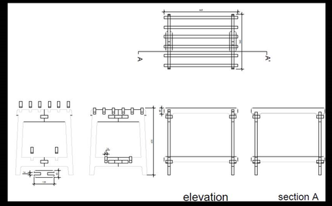

  • Draw the views of the stool in AutoCAD. Draw the front, side, top and section views.
  • These views are drawn to determine the dimension of each part which would be placed on the plywood.
Note: In an architecture firm, all furniture drawings and building plans are drawn likewise to ease communication between the architect, the contractor and the builders.

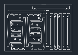

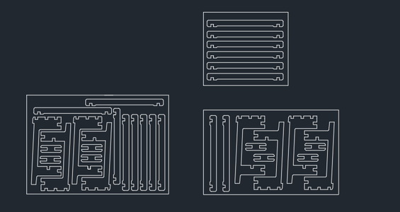

Step 7: Autocad Drawing of Stool Parts.
  • Sketch the parts of stool in AutoCAD.
  • Sketch a rectangle having the dimensions of the plywood and draw the parts within that constraint.
You can derive the dimension of the parts from the plan (previous step)
  • Fit the parts of stool in a rectangle of 600 x 900mm.
  • As it is going to get machine cut, keep a tolerance of 16 to 20 mm between each part.

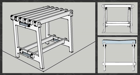

Step 8: Drawing in Fusion 360 or Sketchup
Fusion 360 and Sketch up are two 3D modelling softwares, that help in visualizing a 2D drawing in 3D. You can use either. I had to learn sketchup as the Architecture firm was using this software.

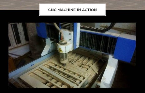

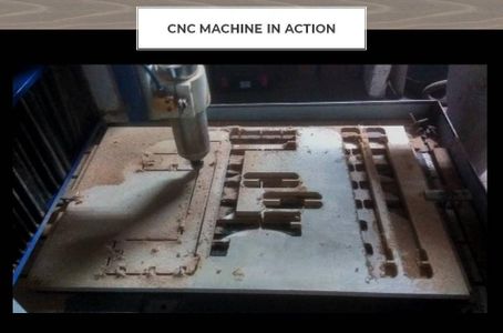

Step 9: The CNC in Action
  • Check in Coral Draw if the parts can be cut by the machine.
  • Import AutoCAD file to CAM (computer Aided Manufacturing) program which will convert AutoCAD to G code. G code controls the CNC mill while cutting the parts.
  • Save the file in a pendrive and insert in machines port and you are ready to make a stool.

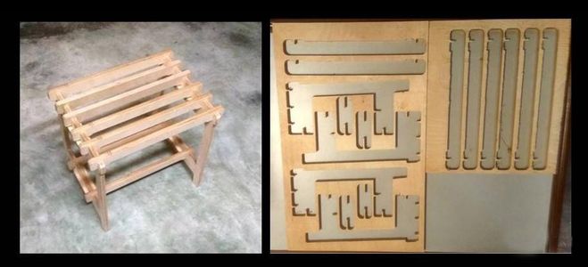

Step 10: Assembling the Stool
  • Once the parts are cut, remove them out of the plywood. It wood look like image 1.
  • Sand each part with 600, 800 and 1000 grade sandpaper.
  • After each part is smooth enough, assemble the stool.
  • Use wood glue to firmly fix the parts.
Caution: Be careful while sanding as ply splinters can easily lodge into your palm. Removing them is more of a pain than wearing a pair of gloves, so wear gloves and handle with care.
