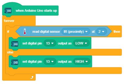

Step 6: Control Uno's Pin13
Here, we will control the Pin 13 LED of Uno by the signals received from the IR Sensor. The pin 13 LED should turn ON when we bring our hand close to the IR Sensor. Similar, it should turn OFF when we take our hand away. Let’s start writing the script for the same.
Since we’re going to upload the code to Uno, we need the When Arduino Uno starts up hat block. Thus, remove the when flag clicked block.
Now, the LED should turn ON when the sensor detects an object; otherwise, it should turn OFF. Thus, we’ll use the if-else block. from the Control palette inside the forever block.
Drag and drop the read digital sensor block inside the hexagonal space of the if-else block.
Next, we'll use the set digital pin () output block below the if arm of the if-else block to turn the LED ON. Set the output to LOW.
Duplicate this block and drop it below the else arm. Then, set the output to HIGH.
With this our script is complete!
Upload the script by switching to the Upload Mode and then clicking on the Upload Code Button.
Step 7: Final Output
Uno’s Pin 13 LED turns ON when you bring your hand close to the IR sensor and it turns OFF as you take your hand away as shown above.
