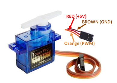

Step 2: CIRCUIT DIAGRAM
Follow the circuit diagram for making the connection. I make this circuit in Easy EDA software.
<<<<< Arduino + Servo Motor >>>>>
5V ----- VCC
GND ----- GND
D9 ----- PWM

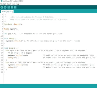

Step 3: ARDUINO CODE
Simply Copy the following code & upload in your Arduino IDE software.
 *    Hello friend welcome to Techno-E-Solution.
 *    Here is a code for Interfacing Servomotor with Arduino
#include <Servo.h>
Servo myservo;
int pos = 0;    // variable to store the servo position
void setup() {
  myservo.attach(9);  // attaches the servo on pin 9 to the servo object
void loop() {
  for (pos = 0; pos <= 180; pos += 1) { // goes from 0 degrees to 180 degrees
    // in steps of 1 degree
    myservo.write(pos);              // tell servo to go to position in variable 'pos'
    delay(15);                       // waits 15ms for the servo to reach the position
  for (pos = 180; pos >= 0; pos -= 1) { // goes from 180 degrees to 0 degrees
