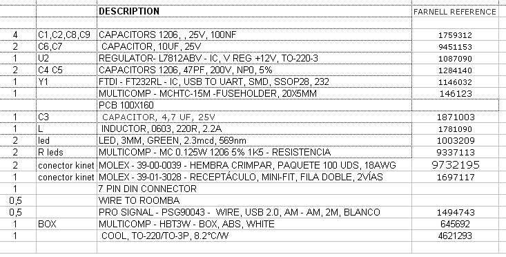

Step 2: Part List

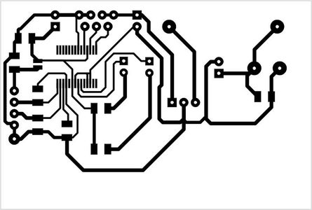

Step 3: PCB Designe
Layout size : 68X46 mm
