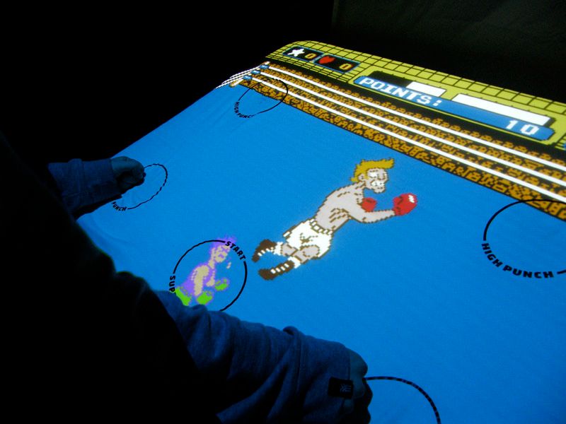

Introduction: Interfaces for Games: PunchOut
This is how to turn Mike Tyson's Punch Out into a full-body workout with real feedback.
(how to make reliable, rugged, touch sensors)
(how to hack a game controller)
(how to make blinding feedback from the game itself)
