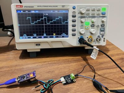

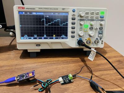

Step 4: Interfacing With Arduino:
Here I have an I2C variant of this DAC module, Arduino I2C has a limited bandwidth and speed, that’s why a limited frequency signal can be generated using this module. To generate any waveform first we have to make an array according to the number of values DAC is going to cover with respect to time. These types of waves are easy to generate; a few examples are shown in the tutorial below. This array of values is known as a lookup table. Which is basically a list of numbers stacked up in a specified format such that values are taken one by one from that list and respective analog signals are generated.
Connect the Arduino with the DAC module as shown in the figure above. Run the serial monitor, plot or get the output on an oscilloscope to see working. Include the <DFRobot_GP8XXX.h> library in the Arduino IDE before uploading the sketch. Download the library files from here.

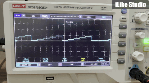

1) GP8211S.setDACOutRange(GP8211S.eOutputRange5V); // set reference to 5V
2) GP8211S.setDACOutRange(GP8211S.eOutputRange10V); // set reference to 10V
3) GP8211S.setDACOutVoltage(13106); // to write an analog value just give data in 15 bit format, here 13,106 is the amplitude value with respect to 15 bit(32,768) data. If the 5V reference is taken then the output value of the analog signal is given by: (5/32,768)*13106 = 1.999V ~ 2V analog DC value.

void loop() { // 15 BIT RES give total steps of 32767 and A Voltage resolution of 152uV at 5 volts Vref.
GP8211S.setDACOutVoltage(6553); // 1V
delay(1000);
GP8211S.setDACOutVoltage(13106); // 2V
delay(1000);
GP8211S.setDACOutVoltage(19660); // 3V
delay(1000);
GP8211S.setDACOutVoltage(26213); // 4V
delay(1000);
GP8211S.setDACOutVoltage(32767); // 5V
delay(1000);

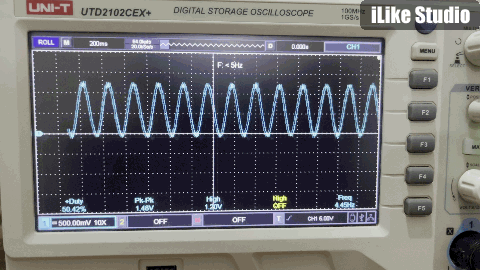

Step 7: Sinusoidal Wave Generation:
To make this look table, every signal has some properties and a mathematical function is attached to every wave. This mathematical function is used to generate the waveform, by inserting one by one values in it or we can use a python script and an online compiler to do the same. Here is an example of a sine wave generated from the mathematical function given below.
The wave can be generated as per requirement of samples, this is a 9 bit wave having a total of 512(2^9) sample points. The amplitude values here range from 0 to 4,096 which is a 12 bit amplitude number. The DAC we are using is 15 bit so the maximum value of amplitude and time which this DAC can see is 32,768(2^15). In this way, the below given look up table is a hybrid 9 bit wave. Which can be easily interpreted using a 15 bit DAC. Any combination of waves can be generated the same 9 bit wave can also be generated using 0 to 32,768 values. Which makes it a 15 bit amplitude wave and 9 bit time wave.

Usually the time axis sample points (512) are enough here, because we have to transmit these 512 values over I2C over and over again to generate a sine wave. Higher the number of time axis points lowered will be the transmission rate over I2C which means lower will be the frequency of signal. To generate a high frequency signal the time sample points to be optimized well.
