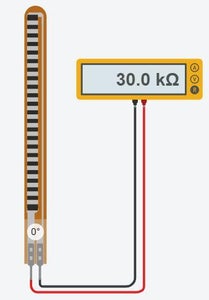

Connect the flex sensor to a multimeter, and set the multimeter on resistance.
Step 2: Resistance When Straight
Note down its resistance when normal i.e. Straight ( bend angle = 0°)

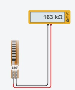

Step 3: Resistance When Bended Fully
Note down its resistance when fully bended ( bend angle = 180°)

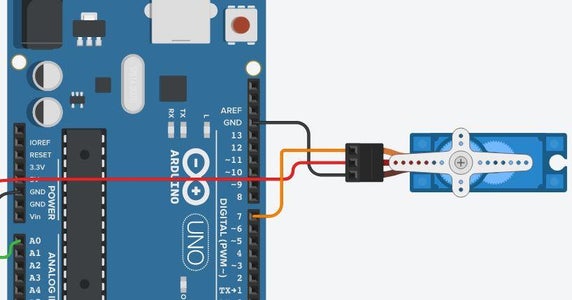

Step 5: Connecting Servo Motor
Servo motor has three pins Power, Ground and Signal power and ground needs to be connected to 5V and GND pins of board respectively. Signal can be connected to any of the digital pin.
