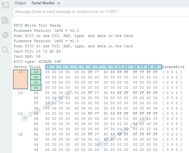

Step 5: Arduino Code to Read All the Data of RFID Card
Upload the following code to your Arduino:
Code to Read all data from RFID card and send it to UART port @ baudrate 115200,n,8,1
by platwithcircuit.com

mfrc522.PCD_DumpVersionToSerial(); // Show details of PCD - MFRC522 i.e., RF Card Reader details
Serial.println(F("Scan PICC to see UID, SAK, type, and data in the Card"));

mfrc522.PICC_DumpToSerial(&(mfrc522.uid));
