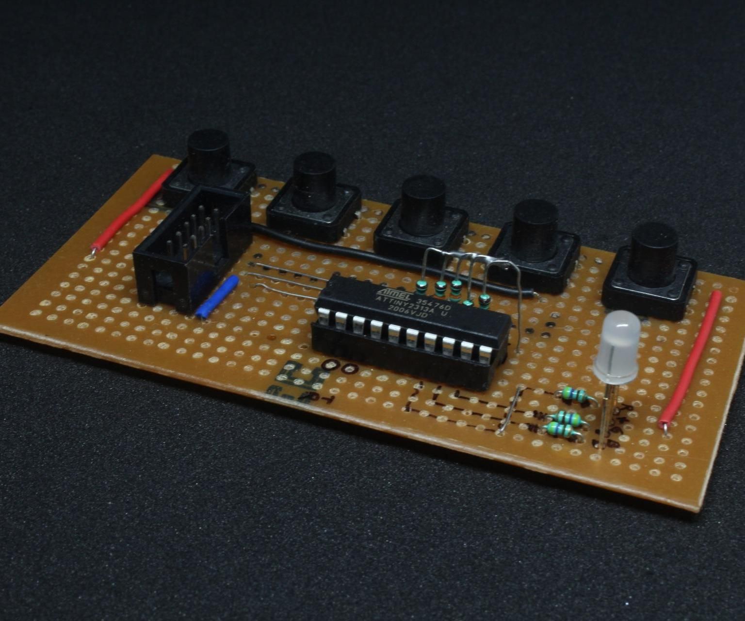

Step 1: The Hardware
The circuit is built on a small 3"x2" Generic PCB. The ATtiny85 in the 8-pin PDIP package has only six I/O lines out of which, one pin is RESET, so, every I/O pin used in this project has been picked very carefully. The connection of the I/O lines can be grouped into three categories:
- I2C Bus
The I2C Bus consists of 2 pins, (i) SDA line for data transmission and (ii) SCL line clock generation. Pin no. 3 is SDA and Pin no. 6 is SCL. Each line has been pulled up using a 4.7K resistor.
- Input Keys
Due to the scarcity of I/O pins, instead of reading the Digital State (High or Low) of 4 input keys, they have been connected to a single ADC input pin as Voltage Divider Network. Each individual Key Press will produce a unique voltage level at the ADC pin. By comparing the ADC data with certain predefined levels, we can find out which key has been pressed. Simultaneous key-press cannot be detected here.
- Analog I/O (Future provision)
Pin no. 5 and 7 are kept empty in this circuit to work with analog data for future use. Pin no. 5 can be utilized to generate PWM driven by the Timer/Counter 0 and Pin no. 7 can be utilized to read the analog voltage (other than the Input Keys) using ADC channel 1.

The project has been done up to this point. Applying 2.4 Volts from a pair of old alkaline batteries, the unit with minimum OLED contrast level and being clocked at 1MHz, is drawing only 3.5mA of current without any Sleep Mode. So, it can be further developed into 4-20mA Current Loop Powered Indicator device.
