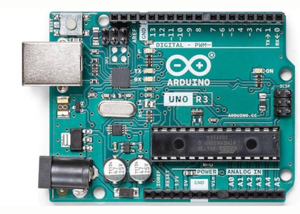

  1. Arduino Uno or any compatible board

Step 2: Connecting the FC-28 to an Arduino
Here's a simple example of how to connect the FC-28 soil moisture sensor to an Arduino and read both the digital and analog outputs:
Wiring the Circuit
  • Connect the soil moisture sensor module to the Arduino:
  • VCC on the sensor module to 5V on the Arduino
  • GND on the sensor module to GND on the Arduino
  • A0 on the sensor module to A0 on the Arduino (analog output for moisture level)
  • Connect the probe to the module:
  • Insert the two pins of the probe into the slot on the module.
