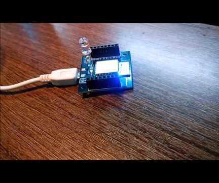

Introduction: Interfacing Temperature and Humidity Sensor(DHT22) With BOLT IOT Platform #BuiltWithBolt
This project is made for the people who want to do work on Internet of Things (IOT) and UART communication.In this project, Arduino will read the data from DHT22 Sensor and send the Temperature and Humidity data to the BOLT(IOT Platform)through UART communication. You can show the separate graph for both Temperature and Humidity with respect to Time on BOLT Cloud.
DHT 22 Sensor: It is a digital output sensor. It is used for both Temperature and Humidity measurement. It uses capacitive humidity sensor and thermistor to measure the surrounding air and spits out a digital signal on the data pin. The operating range of Temperature is -40 to 80 Celsius and for Humidity is 0-100%RH.

In this step, You can upload JavaScript code to the BOLT Cloud and show the separate graph for both Temperature and Humidity with respect to the Time. The BOLT will send data in every 5 minutes on Cloud so that you can see the delay between two reading. You can change delay time according to your requirement directly on the cloud. You need to upload javaScript code for temperature and humidity separately to plot a graph between temperature and humidity with respect to time. You can check images for the javascript code for temperature and humidity.
