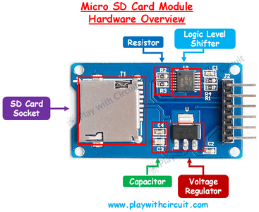

Step 1: Micro SD Card Module: Inside the Hardware
A standard Micro SD card module typically consists of three main components:
1. Micro SD Card Socket
This is the slot where you insert your card. Most modules have small printed symbols or arrows that indicate the correct orientation for insertion.
2. 3.3V LDO Voltage Regulator
Since microSD cards operate at 3.3V, applying 5V directly would damage them. The module includes an LDO voltage regulator that safely steps down the Arduino’s 5V supply to 3.3V. This ensures stable voltage delivery even when the input supply fluctuates.
3. Logic Level Shifter
Microcontrollers like Arduino Uno send signals at 5V logic, but microSD cards require 3.3V logic. The module uses a chip such as 74LVC125A to translate the voltage levels, protecting the card from potential damage while ensuring smooth communication.
