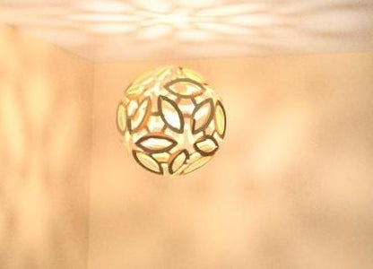

A couple of years ago I produced an ’ible called Polyhedron Light Shade for a near-spherical shade made out of plywood and based on a deltoidal hexecontahedron, a 60-faced Catalan solid. It got a fair bit of attention and was even featured as a Top Project in HackSpace magazine. But making and assembling 60 pieces of ply is a bit of a faff, especially if you don’t have a CNC machine to do it with. Which started me wondering how to create a similar shade, still nearly spherical, but with fewer faces.

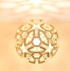

This interlocking icosahedron light shade is the result. It's based on a regular icosahedron, a Platonic solid with 20 identical faces, all equilateral triangles. It's still much easier and quicker to make if you have access to a laser cutter or possibly a CNC router. But if you don’t and are prepared to cut polypropylene or cardboard pieces individually with scissors, at least you’ll only have 20 to cut to produce quite a dramatic shade that casts interesting shadows. That means it's economical to make too, the material for mine cost just over £7.

The previous hexecontahedron design needed so many faces because they are joined at their corners, and the only sensible way to join flat pieces of material at their corners – ie single points – is to lap one over the other. If you try to do that with fewer, larger pieces of relatively stiff material like plywood then each one has to bend quite a lot and they will likely break. And if you do it with a bendier material like polypropylene then it may well flop and sag instead of holding a spherical shape.
The solution is to join the individual elements that make up a shade at their sides, not their corners. When the zone of contact is a line rather than a point, it stiffens the structure and makes it better able to support its own weight. Joining the polyhedron along its edges means it’s possible to interlock adjacent elements rather than overlapping them, and that gives quite a different appearance to the overall design. It also means that the faces can remain flatter, so it’s not necessary to have a hole in the middle of each one to allow it to bend without snapping – although I think it looks better if the centre of each face isn’t solid.
For me, 20 faces is a good compromise which avoids having to cut and assemble dozens of elements but still produces an interesting, near-spherical shape. Having settled on a regular icosahedron, I again used Rechneronline's geometry calculator as a shortcut method of working out how long the triangles’ sides should be to give me a shade of the size I wanted – although I did need to adjust things later to fit the elements on the laser cutter’s bed in a non-wasteful way.

Fusion 360's rendering capability works really well for light shades if you put a light source inside the shade and provide some surfaces for the shadows to fall on.
Create a 60mm diameter sphere in the centre of the modelled shade to represent a light bulb, then give it the appearance of a 1,500 lumen emitter. This can be found under Miscellaneous, Emissive in the Appearance menu.
Create two more bodies in the X and Y planes, fairly close to the light shade, to represent walls, and a 4th to represent a ceiling over it. Apply whatever pale colour you wish to them using Appearance.
Now go into the Render workspace and adjust the view to show the shade (and bulb) with the walls and ceiling in the background. In Setup, Scene Settings choose a very low level of background brightness. Then perform the render and let it go to at least the Excellent level. You’ll see the shadows the shade casts, as in the images above.
