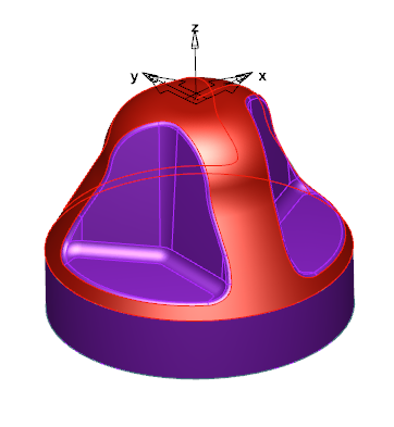

With a blank milling document open, we can now import our solid model to program features from.
  • Import Ultimate_2_Part.x_t
The Import Wizard will help us setup our part, covering our stock step, as well as some of our machining prep.
  • Align the Z direction
  • Align the X direction
  • Select a simple block stock material computed from size
  • Place the Setup in the center of the stock
  • 5th Axis Positioning
Now that we have gone through the familiar process off importing and setting up our solid model, let's import a model to be used to define our stock material, as if we are machining a part that has already been through an operation on a lathe.
  • Import Ultimate_2_Stock.x_t
  • Use the same alignment as last import
With our stock solid model imported, we simply need to apply this model to the Stock section of FeaturCAM
  • Select Ultimate_2_Stock.x_t as Stock Solid
    • Open the Stock Properties dialog
    • User-Defined
    • Stock Solid
    • Select the model we imported to define the stock
    • Hide the stock solid

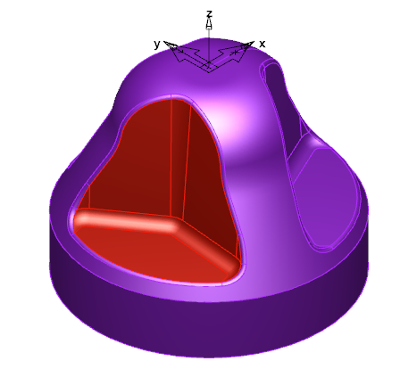

  • Create a Z-Level Roughing operation to rough the part
    • Surface Milling
    • Select the entire model
    • Choose a single operation
    • Z-Level Rough
  • Create Z-Level Finishing operation with a 0.25" Ball End Mill
    • Surface Milling
    • Select all the surfaces in one of the three recessed triangular areas
    • Z-Level Finish
    • Cut select surfaces
    • 0.25" Ball End Mill

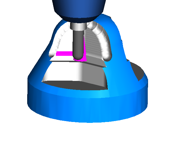

  • Run a 3D Simulation
  • Run a Machine Simulation
It looks like we have a few issues to correct with our toolpath. First, we obviously have a gouge, and will need to add some multi-axis control to avoid any collisions. It also seems that our cutter is cutting past the edges we specified.
  • Add a Check Surface to help limit the toolpath
    • Srf_mill2 Properties
    • Dimensions
    • Check Surfaces
    • Add the top surface of the part

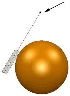

From Point - This option aligns the tip of the tool away from a fixed point, The angle of the tool is constantly changing. The tip of the tool moves significantly while the head of the machine tool stays relatively still.

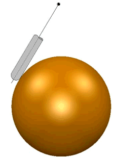

To Point - This option aligns the tip of the tool towards a point. The angle of the tool is constantly changing. The head of the machine tool moves significantly while the tip of the tool stays relatively still.

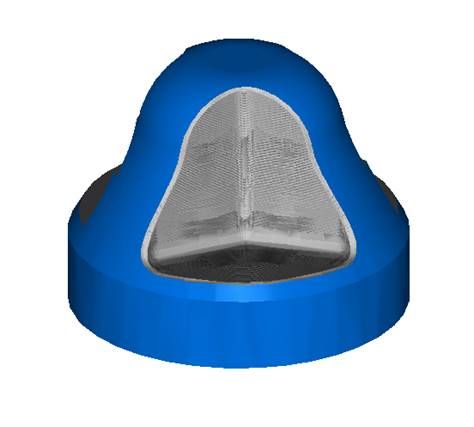

  • Alter the Z-Level Finish toolpath to use the 'From Point' multi-axis option
    • Create a point at (-1.5,0,0)
    • 5-Axis Tab
    • From Point
    • Select the point just created
    • Reduce the z-increment (stepdown) to 0.01"
  • Use 'Interleave spiral paths' to ensure toolpath is generated on the flat surfaces
    • Z-Level Strategy
    • Check 'Interleave spiral paths'
Now that we have fixed any glaring errors with the toolpath, and explore the 'From Point' option, let's take a look at the inverse of 'From Point' - 'To Point'.

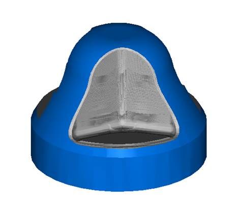

    • Create a point at the center of the bottom surface of the solid (0,0,-2.1)
    • 5-Axis Tab
    • To Point
We can see that we are able to achieve a very similar result using the 'From' method instead in this case. The remaining 'To and From' methods all operate the same, only they reference lines or curves instead of points.
