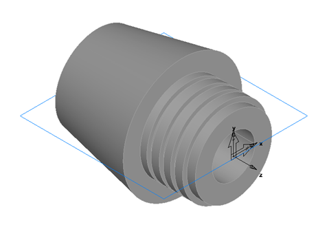

With a blank milling document open, we can now import our solid model to program features from.
  • Import Turning Part 2.x_t
Once the part is imported, we are met with the Import Wizard, and reach the next step in our Workflow – Stock.
The Import Wizard will help us setup our part, covering our stock step, as well as some of our machining prep.
  • Align the Z direction by using ‘Align z with center of a revolved surface’
  • Reverse Z if necessary
Step through the next few windows in the import wizard to define the piece of material we will be machining this part from
  • Round stock shape
  • OD: 2”
  • Length: 2”
  • Length Offset: 0.03”
  • ID: 0
  • Place the Setup at face of the stock and offset the Z so that the setup is even with the part face, as opposed to the stock face.

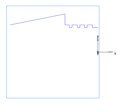

First, lets create a turn feature. This still needs to be created from a curve, but this time we can draw the curve directly from the geometry.
  • Create a curve from Revolved Boundary with convert to geometry on
  • Use pick pieces to create a curve along the outer profile of the part

  • Create a Turn Feature from curve
    • Use curve 1
    • Press Finish

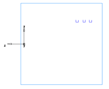

  • Use pick pieces to create a curve along the groove profiles
  • Create a Groove Feature from curves
    • Use curve 2
    • Press Finish
  • Repeat this process for the remaining 3 grooves

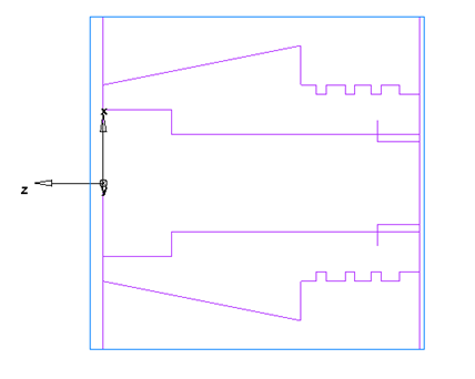

We can use the same geometry we extracted from the revolved boundary to create curves for this set of features.
    • Use curve 1
    • Press Finish
  • Use pick pieces to create a curve along the Bore diameter
  • Create a Bore Feature from curves
    • Use curve 5
    • Press Finish

When you are done, your features should look similar to the features shown below.

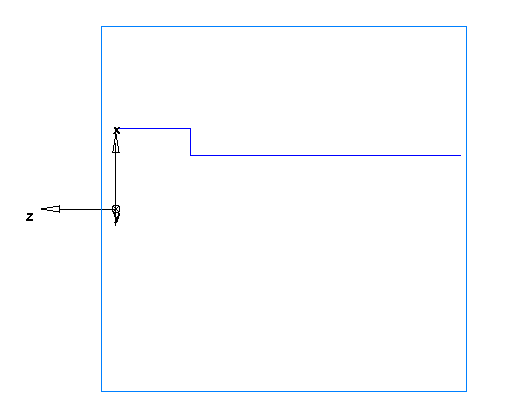

We can see that there is a thin piece of material left after the first turn feature. The turn features will also collide with the clamps holding our part when this program is run on our machine. We could change the curves guiding each feature, but let’s look at another option which we which is to limit the features with a boundary.
  • Open the turn1 properties window
    • Select the Rough operation
    • Open the Turning tab
    • Change Boundary (spindle side) to -0.8” then press Set
    • Apply and then OK
  • Open the turn2 properties window
    • Change Boundary (spindle side) to -1.3” then press Set
    • Apply and then OK
