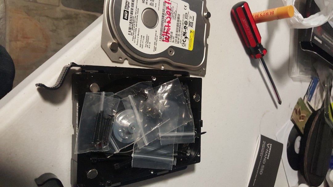

Step 1: Take Apart the Harddrive.
Start by taking off the cover. Note that there may be a hidden screw under the label.
Once inside you need to remove as much as you can without leaving a hole in the bottom. Its for this reason that I had to leave the motor inside the hard drive. It wouldn't be a very good hardware tray ifit dropped the hardware right out the bottom.
But you can easily remove the platters, magnets, and whatever you call the little arm. I'm really drawing a blank on that right now.
Step 2: Install Fasteners
Now you can install your fasteners. I only have a solid state hard drive, so I drilled holes and installed magnets. I also glued magnets to the top of the case (who knew the case wasn't magnetic).
Most people would probably prefer to use something along the lines of thumb screws. Especially in close proximity to other hard drives, where neodymium magnets can cause data loss and damage.
