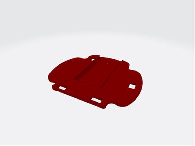

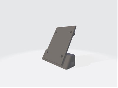

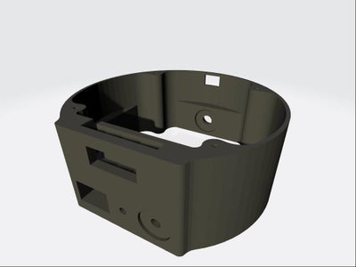

Step 3: The Base Section
Print the 001 Base Section Outer Shell with supports as it has holes for the switches. I printed the 002 Inner Plate in red so you can see the contrast of the two components. The supports can quickly be removed with a pair of fine nose pliers. It's now a good time to test fit the components that will go into this section of the body including the barrel power jack, the on/off switch, the buzzer, the touch switch and the OLED display
All of the holes in the inner plate can be drilled to 2.5mm and then tapped with an M3 thread. These will be used as fixing points for the battery case and the stepper motor driver. Remember to tap the battery mounting screws from the underside (flat face) and the stepper motor holes from the topside (with recess for veroboard).
The inner plate should slot into the main body of the outer shell and it will sit on two ledges. To hold it in place, I added a few drops of superglue.

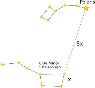

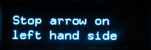

When describing the motion of an astronomical device, the left-to-right rotation of the base is know as the azimuth. The azimuth stepper motor driver is located in this section too. The pre-made ULN2003 boards are often left with long component leads after they have been soldered in place, so it is a good idea to trim these flush. The stepper motor driver board can now be fixed in place with machine screws.
Connect the ESP32 to the battery power supply, the azimuth stepper driver, the OLED display and the touch switch according the wiring diagram.

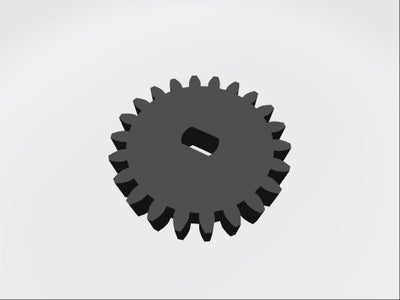

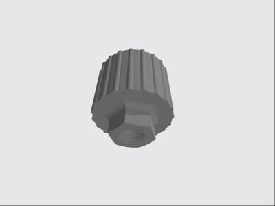

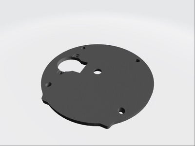

Step 5: The Spindle Plate
3D print the following components:
  • 003 Spindle Plate
  • 003 Centre Spindle
  • 003 Spacer for Rotating Platform
  • 003 Involute Azimuth Gear
This is a straightforward assembly. Fix the stepper motor in place with machine screws, washers and nuts so that it is held firmly in place.
The thread of the spindle could be cleaned up with an M8 die and the hollow centre should be drilled with an 5mm drill to ensure no printer threads catch the wires as they are passed through.
The spindle locates in the plate with a key that stops it from rotating. A drop of superglue ensures it does not get pushed out.

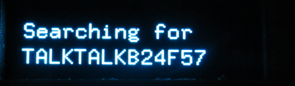

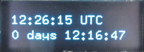

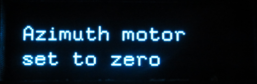

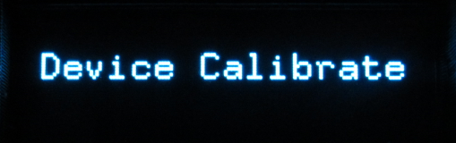

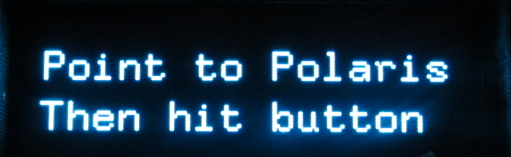

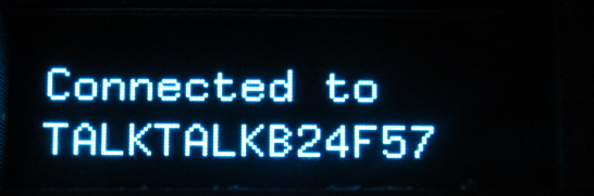

Step 7: Software
Here is the main program that controls the ISS tracker. Make sure you download the .ino file above, rather than copy and pasting the text from this page to ensure you have the correct formatting.
I have also included a couple of test files so you can check the operation of your touch switch and stepper motors as you build the device.

// ######################### calibration section ###############################
  display_message("Stop arrow when","pointing down");
  while (touchRead(T0)> touch_threshold){
    elevation_motor.move(400);
    elevation_motor.run();
  // button has been pressed when elevation pointer is downwards
  display_message("Elevation motor","set to zero");
  elevation_motor.setCurrentPosition(0);
  delay(1000);
  display_message("Stop arrow on","left hand side");
    azimuth_motor.move(400);
    azimuth_motor.run();
  // button is pressed when azimuth pointer is forwards
  display_message("Azimuth motor","set to zero");
  delay(2000); //pause to let you know button has been pressed
  azimuth_motor.setCurrentPosition(0);
  // move the elevation to point to Polaris
  // this angle is the same as the latitude of the observer, reference point downwards, so +90
  elevation_motor.moveTo(steps_per_degree * (my_latitude + 90));
  elevation_motor.runToPosition();
  display_message("Point to Polaris","Then hit button");
  while (touchRead(T0)> touch_threshold){}// wait for button press
  display_message("Now calibrated","");
  // ######################### end of calibration section ############################
  // ######################### Connect to WiFi #######################################
  Serial.println("ISS Tracker");
  display_message("Searching for",ssid);
  Serial.println(ssid);
  WiFi.begin(ssid, pass);
  while (WiFi.status() != WL_CONNECTED) {
    delay(500);
    Serial.print(".");
  Serial.println("Connected to wifi");
  display_message("Connected to",ssid);
  // ######################### Synchronise Time with UTC ###############################

void loop() {
  events();// this ensures the motors keep moving
  //Serial.println("COOKIE:      " + UTC.dateTime(COOKIE));
  //  Serial.println(dateTime(next_pass_timestamp, "D d-M H:i:s"));
  if (now()+next_duration > next_risetime){// only get next flyby once current one has gone by
    get_next_pass(my_latitude,my_longitude,next_risetime,next_duration);
  Serial.print("Next flyby:");
  //Serial.print(dateTime(next_risetime, "D d-M H:i:s  "));
  Serial.println(time_to_next_flyby(next_risetime));
  point_to_ISS();
  delay(1000);
  //display_message(UTC.dateTime("H:i:s T"),my_timezone.dateTime("H:i:s"));
  display_message(UTC.dateTime("H:i:s T"),time_to_next_flyby(next_risetime));
Step 8: The Rotating Platform
  • 004 Rotating Platform
  • 004 Long Collar
  • 004 Slip Ring Holder
  • 004 Elevation Motor Housing
  • 004 Elevation Driver Mount
The rotating platform needs to have a 60002RS bearing inserted into the centre. It is a tight fit, so a hot air gun can be used to heat up the metal body of the bearing and the centre of the rotating platform. A gentle swirling motion of the heat gun ensures that the area is not overheated as it will quickly deform if too much heat is applied. The bearing can then be located on top of the recess and pushed into place with a flat piece of wood. As the PLA cools down, it holds the side of the bearing securely.
At this point, you might want to run the involute azimuth gear around the inside to the rotating platform to ensure that the gear teeth mesh freely and don't get caught on any printing imperfections.
The 004 Elevation Driver Mount can be secured to the rotating platform using M3 x 12mm countersunk machine screws and captive nuts held inside the driver mount. The circuit board is attached with M3 x 10mm machine screws that screw into the tapped holes of the printed driver mount.
The elevation motor housing is also held with screws and captive nuts and the stepper motor will fit snugly inside the housing. You might find it helpful to use tweezers to locate the captive nuts in the right place.
The stepper motor wiring loom can be plugged into the drive. Be careful to keep the wires clear of the central spindle as this will be rotating.
Slip the spacer ring over the spindle and then the rotating platform assembly. The long collar can be placed over the spindle. The six wires of the slip ring should be passed through the slip ring holder and then threaded through the hollow spindle - this can be a bit tricky, but is easier todo it one wire at a time. The slip ring holder may now be screwed onto the spindle. This will be tightend down finger tight to check the rotating plate can move freely on the bearing. The rotating plate will not spin around quickly, but the components mounted on top of it have been placed on opposite sides so it can be as balanced as possible. When all the parts are in place, you can secure the slip ring to the holder with three self tapping screws.

Step 10: Calibrating the Device
When the device is first switched on, it needs to know where the pointer is pointing. At the moment, this process relies on the operator. This is the pseudocode for the basic operation:
  • Align zero reference point for elevation (towards Earth is zero)
  • Align zero reference point for azimuth (on left hand side of device)
  • Raise elevation to pole star, Polaris.
  • User manually aligns the device accurately; it is now aligned with true North.
