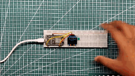

Step 1: Basic Setup With ESP8266 Board
We first start by preparing a Breadboard setup first, we place the ESP8266 Nodemcu board and OLED on a Breadboard and do the following wiring connections.
  • 5V of NodeMCU to VCC of OLED Display
  • GND to GND
  • D2 to SDA
  • D1 to SCL
After this, we add the main code into the NodeMCU and you'll see Time and Day displaying on the OLED Screen.

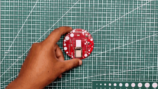

Next, is the PCB Assembly Process.

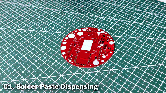

Step 6: PCB Assembly Process

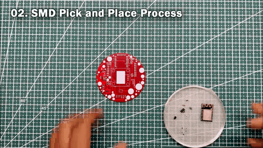

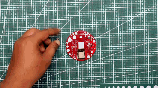

  • We first start the PCB Assembly Process by adding Solderpaste to each component Pad one by one with help of a Solder Paste Dispensing Needle

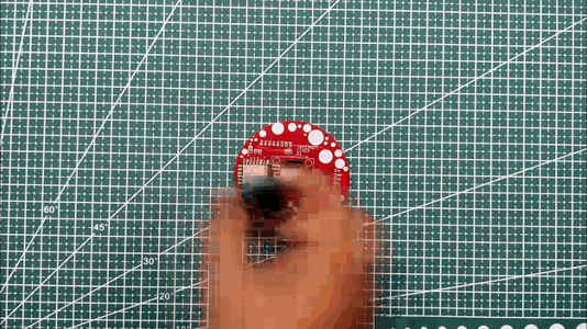

  • Next, we gather all the SMD Components and place them in their location by using an ESD Tweezer.

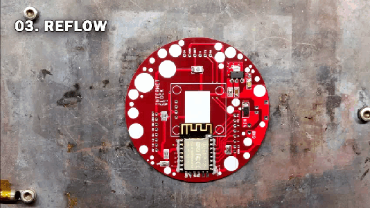

  • We then place the PCB on a Reflow Hotplate to melt the solder paste.

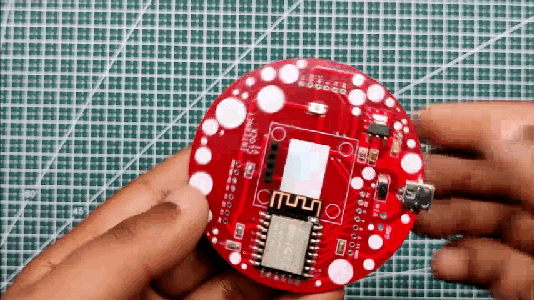

  • Next, we place the header Pin and USB Port in their place and solder them using a standard soldering Iron.
  • At last, we place the SSD1306 Display on the header pin connector, and the Board is now completed.

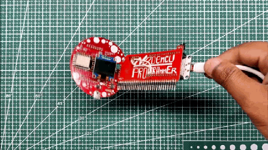

Step 7: Flashing the ESP12F With an NodeMCU ESP8266 Board
For Programming the ESP12F module, we use a Nodemcu board. Let me show you how.
we start first by shorting the Enable pin and GND, this will turn off the esp12f of the Nodemcu and now we can hook an external esp12f setup with the Nodemcu according to the following wiring connections.
  • 3v to 3v
  • GND to GND
  • RST to RST
  • GPIO0 to GPIO0 //D3 is GPIO0 on Nodemcu
  • TX to TX
  • RX to RX
I made a Nodemcu Breakout board that has a CON6 Port connected with the Programming Pins, same pins are added to the ESP Watch PCB. The idea here is to connect them both and use the Nodemcu's UART IC to program the ESP8266 Board by disabling the Nodemcu's ESP8266 Board and using an External one.

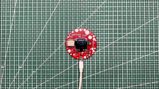

Step 8: Result
Here's the result of this built, a working Digital Clock that displays DAY and Time.
This device can now be added to any wall or we can make a 3D-printed enclosure for placing on a desk.
