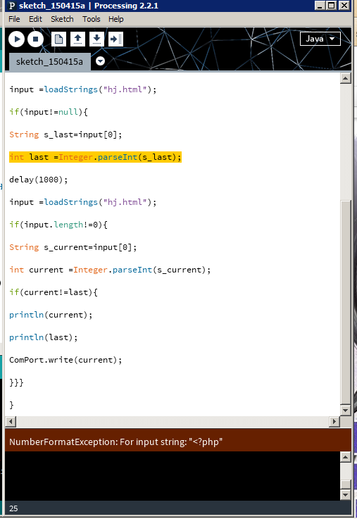

Step 4: Put It Together With Processing
Processing is a useful little tool that comes in handy when interfacing the Arduino with the computer (among other times).
The point of the processing app is to retrieve the data from the text file on your server and feed it, through the serial port, to the Arduino. To send the data we need the processing serial library. To start we set up the serial port at the same baud rate as we set the Arduino (9600). In the draw loop we begin by retrieving the data from my text file using loadstrings("url"); which returns an array of strings, each element being a line of text from the document. I then parse the array element into an int so it is a primitive instead of a reference variable, and I can compare its value. After waiting a second I retrieve another value and if they are different I know that something has happened and I need to tell my Arduino, so I send the data using ComPort.write(data);. I also test for nullity throughout so I do not accidentally pass on misread data.

- Go to your website and submit your forms!
