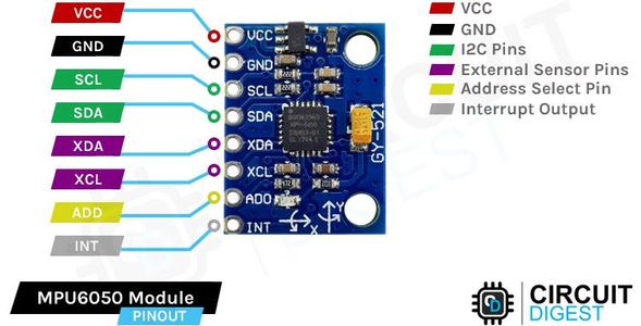

We make the 4 connections as follows:
1) MPU6050 SCL pin to pin 22- ESP32
2) MPU6050 SDA pin to pin 21- ESP32
3) MPU6050 Vcc pin to 5V-ESP32 pin
4) MPU6050 GND pin to GND-ESP32 pin

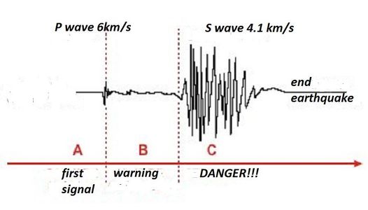

The operating principle is based on the difference in travel speed between the two types of waves of an earthquake: the P wave, the first one that is felt, with a travel speed of about 6km/sec and is practically harmless, and the S wave, the one that causes destruction and loss of human life with a speed of 4km/s. Practically, the greater the distance from the epicenter, the longer the time between the detection of the 2 types of wave. This small project focuses on this aspect.
