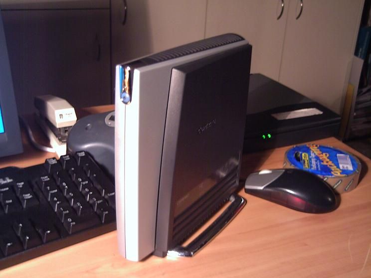

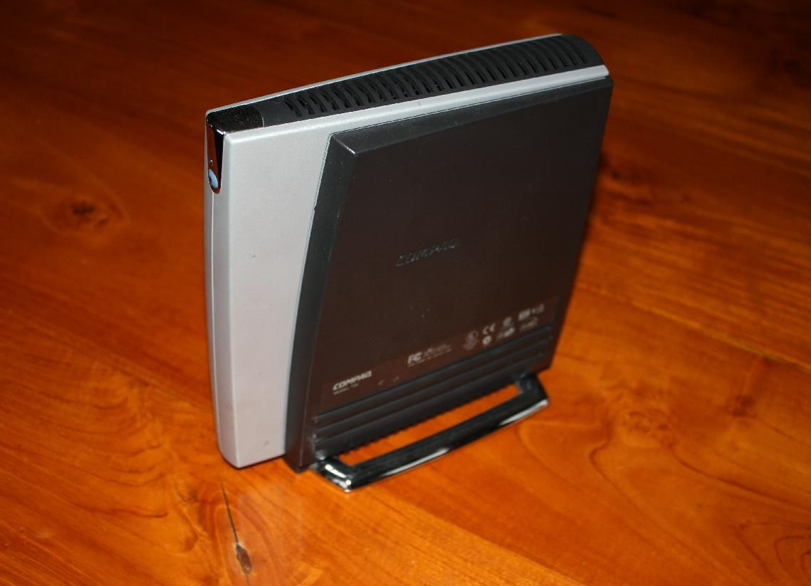

Step 1: First Buy Your EVO T20
Not all Evo T20 thin clients are the same some are quite high specificationed and some are basically Junk - To do this you Need one of them that Runs Windows Nt4e or Windows XPe with enough flash memory basically the 64 megabyte or better . The Windows Ce ones are totally unsuitable for this Project and are basically a Door stop: They all look the same and use the same 5 volt 4 amp power supply the only way to tell them apart is by the part number ; This is located underneath the unit. Other Thin Clients that I have tested and work are the Compaq EVO T30 Thin Client and for the Ultimate Version the " Hp T5700 which can be used as a Video Host".
Fortunately lots of information is available online at the HP web site and other sources http://h18000.www1.hp.com/products/quickspecs/10865_div/10865_div.HTML
The following Part numbers are the ones it should work on from the HP list
305253-xxx 308791-xxx 311334-xxx
306480-001 is what I have used (128megs of ram and 128meg of flash ) in the demo After several trials any T20 or T30 with 64 megs or more is a possible candidate. With a 64 meg flash you have the options to source a 32 Meg smart media card ( if you can find one ) - slip that into the socket on the EVO's mother board then reflash it as a 96 Meg unit.I have found no way of making a Ce Unit into a NTe. With Windows media player installed a 64meg flash unit still has 9megs of spare space
You will also need a USB mouse a USB key board and a VGA monitor and Wired Internet (a Rj45 cable feeding broadband Internet From a router Ideally set in DHCP mode to give out network Ip addresses)

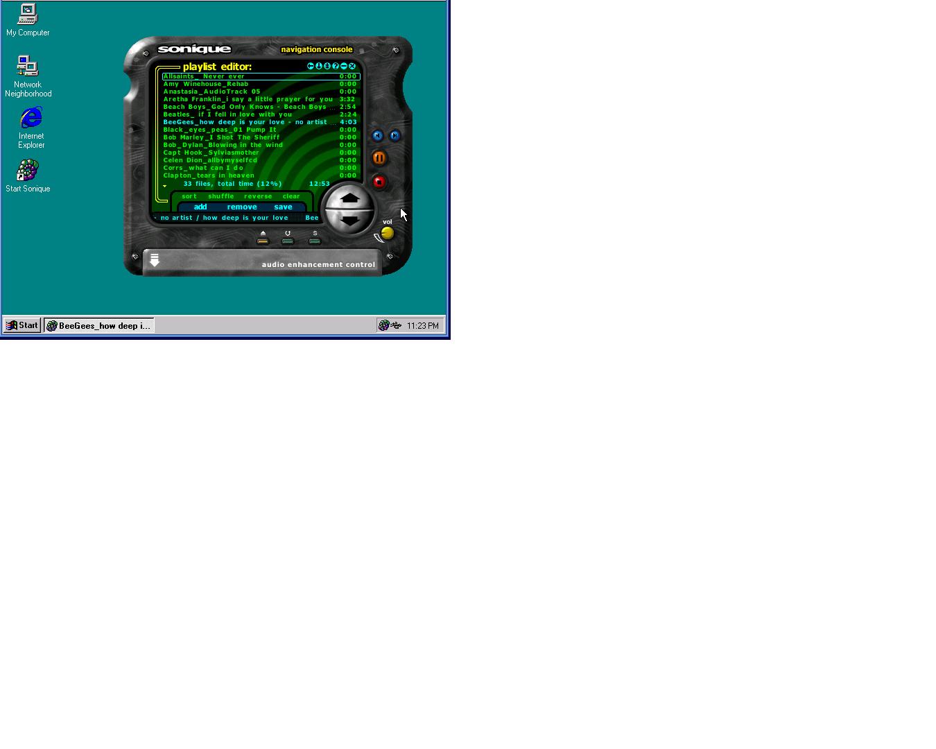

Step 5: Install Software Specifically Real Player
For Most Internet Radio stations you need to install a compatable Windows Media Player ( which can be optained dirrect from microsoft from www.microsoft.com/downloads/details.aspx and for others you need to have a version of Real player installed, If you look at [http://radio.real.com/] there is an up to date list of the Many Internet stations you can set this particular Unit up to stream. - Do not try to install the latest version its to big and won't work you need a specific older version , Version 8 This is where a networked computer with a shared dirrectory comes in Or a Pen drive . The software can be down loaded from
http://forms.real.com/real/player/blackjack.html or By Doing a Google Search -I have also put it on a page on My own website so it will remain available at
http://www.xmailed.com/evot20/index.htm
You need to save this in the shared dirrectory as there is not enough space on the EVO's C drive for the compressed install file and to expand the files for the install ( this will be done in the now enlarged Z: drive [30megs] do not install the extras like jukebox basically tick no to every option and should intall without problems -
reboot the EVO and only one or two steps now left .
