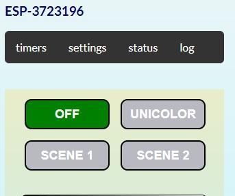

connect to wifi
Once the software is uploaded, the wemos boots and the blue LED is lighted up continuously. This means an accesspoint (AP) is opened where you can connect it to your wifi. Now open the wifi settings on your laptop, phone or tablet. You'l see a netwerk called ESP-123456 or similar.
Connect to this network with password 123456789 and browse to 192.168.4.1. Enter your credentials and follow the further instructions.
Don't forget to set the administrators password. Default this is 000000000. When successfully connected, the ESP will reboot and the led flashes 3 times.

After the first boot you should do some housekeeping first. Go to the settingspage and click "time config". Here you can set your geographical position and the time offset. If daylight time saving is applied in your country than check that. Save. The device reboots and calculates the sunset and sunrise times. Check the status page to see if all is correct.
servo settings
It is important to do the servo settings. We don't want the servo to move to positions where it's vibrating, as this is a high current state and might destroy your servo or even your nodemcu. Visit the servo page, here you can determine the extremes between which the servo can move safely. Call it the open and closing position, or vice versa, to determine what happens when you hit the close or open button. This makes it very easy to adapt the servo to your specific project.
You can also determine the speed of the servo movement. Check "slow closing speed" if you don't want to catch birds in your feeder.

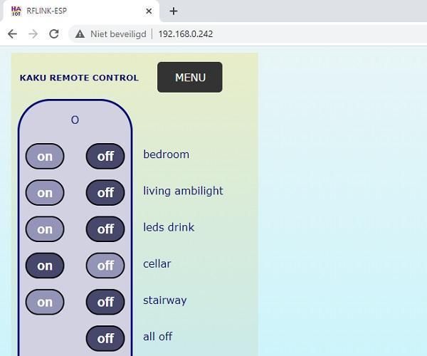

domotica
The servo can also be controlled by domotica applications like "domoticz". By sending a http request like "ip-of-espservo/SW=ON" (close) or "ip-of-espservo/SW=OFF", the servo can be controlled. You can test this in your browser.
mosquitto
When mosquitto is enabled, messages such as {"idx":"123","cmd":"SW=ON"} or 123,SW=ON can be send to the servo. On open or close events, json messages are sent like {"idx":123,"nvalue":1}. This json format and can be understand by domoticz.
