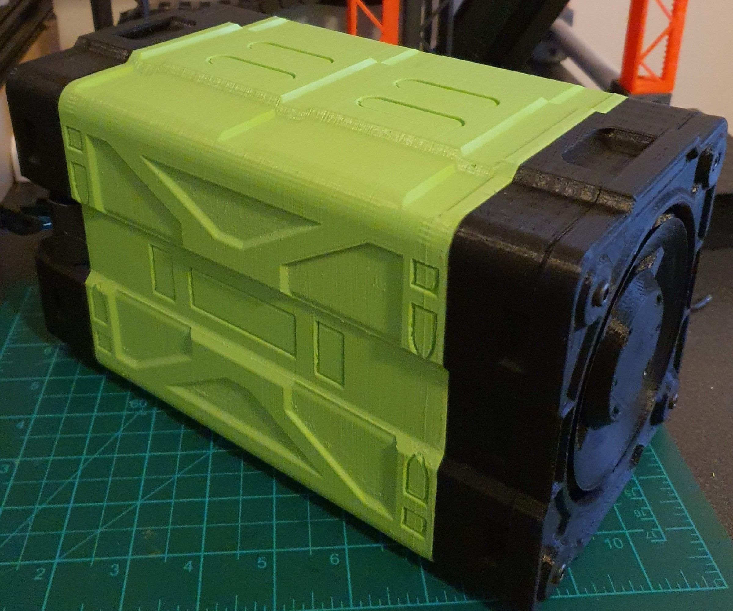

Step 4: Case Design
To contain everything, I designed an enclosure in fusion360 and 3Dprinted it. The design I made is relatively simple. I used hot glue to fasten the components to the inside and the gauge is held in place by being pinched between the front cover and the back cover. You do not need to use 3D printing to create the case. For example, you could make a case out of wood, or you could put everything back in the original case that the gauges came in.
My STL files are available on thingiverse if you want to look at them but it is unlikely they will work for you unless you get the exact same gauges I used.
