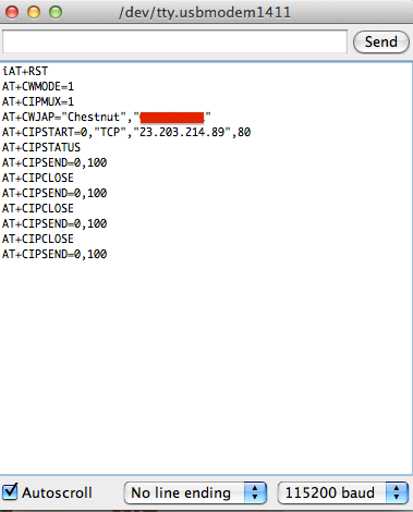

This function is the meat and potatoes of our code. So what we have here is a command (AT+CWJAP) that is telling our ESP to join an access point. It is followed by the AP SSID and password. If the ESP returns "OK" then we've successfully joined the AP. If not, the connection failed. If you're using a MEGA or other multi-serial microcontroller you can set it up to send the PC messages of what's going on. I'm sending my data over I2C to an FPGA, so I just threw away the responses.

This part is fairly simple. If you're like me and not super concerned about the logic level shifter, just connect the two together. Make sure you connect the RX of the ESP into the TX of the Arduino and the TX of the ESP into the RX of the Arduino. If you don't the ESP and the Arduino will both be yelling at each other but nobody will be listening. Connect your VCC pin to 3.3V and your GND to, well, ground. The only sneaky pin here is the CH_PD pin. This is the Chip Powerdown pin. When this pin is low it tells the ESP8266 to power itself down. If you want close control of the ESP tie this into one of your GPIO pins on the Arduino, otherwise just connect it to 3.3V so the ESP is always on. For even more control tie the RST pin on the ESP into the Arduino too. This way, if need be, you can perform a full hardware reset on the ESP.
