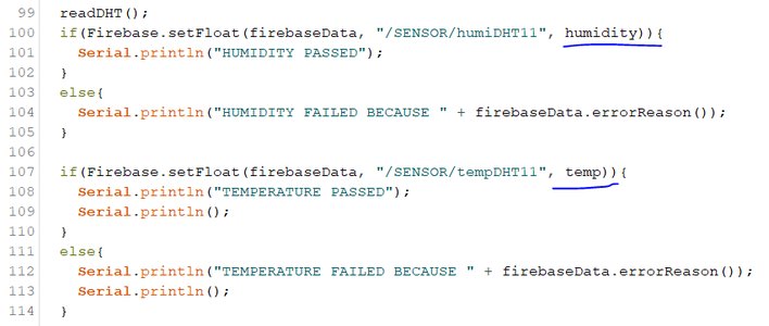

  4. Pay attention to the part when sending data (see picture). The bottom line is the Device ID of each sensor. Device ID serves as an identifier for each sensor

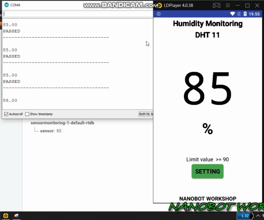

  1. Open the application. If at the beginning there is a warning like the one below it means that the application is not connected to Firebase because we have not set the Firebase URL and Firebase Auth
  2. Open Settings. Enter the Firebase URL and Firebase Auth. To make it easier to enter the Firebase URL and Firebase Auth you can make it a QR Code first on the site https://www.qr-code-generator.com/. Create a separate QR Code, don't combine the QR Code Firebase URL and the QR Code Firebase Auth. After the QR Code has been created, press scan to scan the QR Code
  3. Click Save to save the Firebase URL and Firebase Auth. Return to Home
  4. To add a device, click Add Device
  5. Enter Device ID, Device Name, Unit of Measurement, Description, select operator for Limit Value if you want to add Limit Value, and Limit Value. For the device ID, match the program on the Arduino IDE or it can be seen in the Firebase Database
  6. Add the device according to our wishes. Here we enter 4 Devices
  7. Click Device to find out info about the device
  8. To change the name, measurement unit, description, comparison operator and limit value, click Edit
  9. Click Save to save
  10. Click Delete to delete the device
