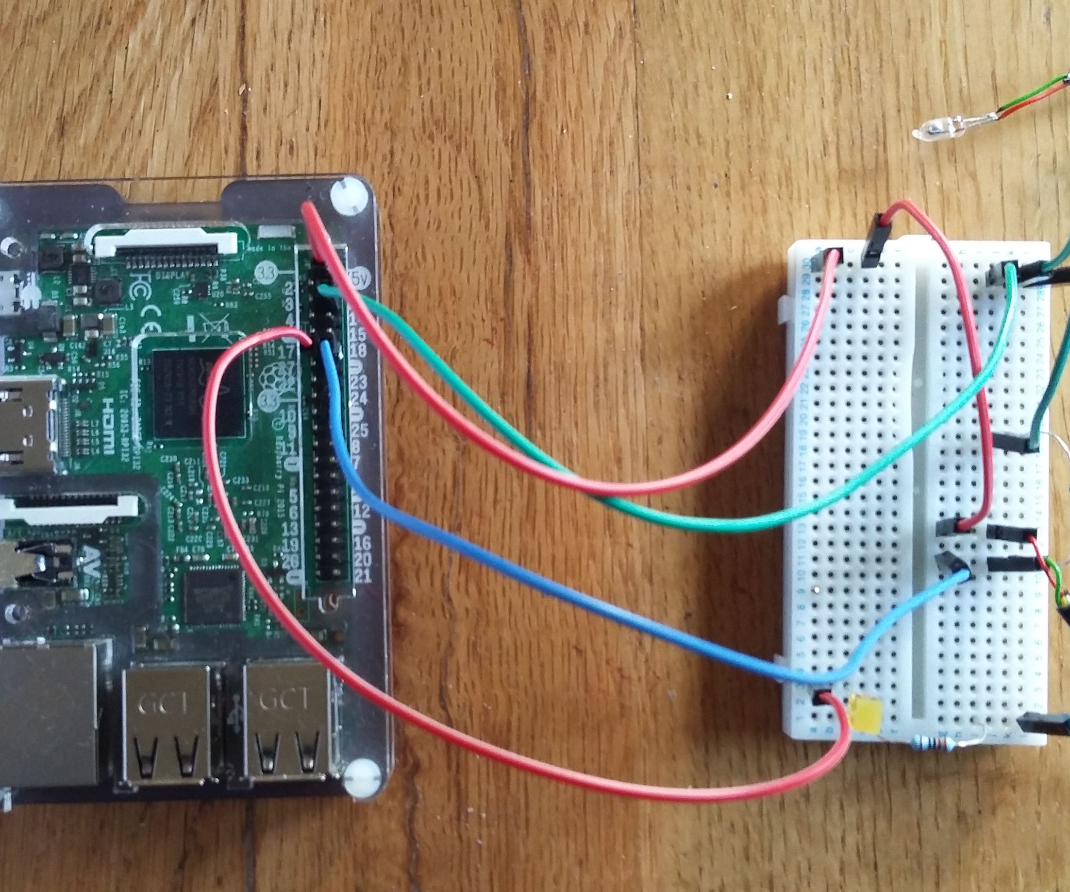

Step 2: Getting the Code Right
To program this Lighthouse I used a Raspberry Pi and Python. I'm more familiar with Python than Arduino and felt getting it working first and proving that the idea was sound was important. Then when working it would be just a matter of recoding into Arduino.
So with a Raspberry Pi set up with a string of WS2812 LED as per this web site I like and also the Adafruit Raspberry Pi Neopixel guide for the software installation you can code away.
Testing like this ensures that the LED will work and the sequencing makes sense.
The hardest part is getting the colours correct for the temperature scale. Look at the graph above to help this next bit and the code make sense. Starting from the lowest it is all blue values for the LED setting (Red, Green, Blue) = (0, 0, 170).
As the temperature climbs the green values are added and the blue ones subtracted until the midpoint is reached when it is all green (0, 170, 0).
From then on the green is subtracted and the red increased until the maximum point is reached at (170, 0 , 0).
I feel that the LED do not need to be at full brightness so the scale goes from 0 to 170 instead of 255. As the scale of 170 colour levels does not always divide exactly equally between the needed temperature steps, at each point minimum, midpoint and maximum the levels are fixed to the max or min levels in the code.

Step 4: Make the Lighthouse Light.
The lights in the Lighthouse were to consist of 6 WS2812 LED placed in a circle. I used three bottle tops glued together as the base to hold them. This just fits nicely inside an upturned yoghurt pot.
The LED strip needs to be cut into individual LED and placed onto the bottle tops. I put a dab of hot glue in the middle just to hold them in place and then used two thin strips of electrical insulation tape to really secure them in place. On my first attempt I found the heat from the soldering iron remelted the hot glue quickly and the LED came unstuck easily.
Place them one right way up then another upside down equally spaced around the caps. The first one in the sequence will have the wires running into it from the bottom then you will need to solder very carefully wires from top of the +V, Din and Gnd from one LED to the next as in the picture above. Repeat for all the LED following the arrows except for the last one which is not connected to the first.
I then got three male to female breadboard jumper leads and gently bent the male end by 90 degrees. This so the leads will tuck underneath the caps making it nice and easy to hot glue the cap to the top of the lighthouse. I also cut away the cap behind where the wires came out of the LED so it make a neat finish.
Once it was all wired up the female end of the leads just connect to the D7 (GPIO 13) for the Din, Gnd to Gnd and +V to the 5v of the NodeMcu. Power up and hopefully watch your lights go round and round.
