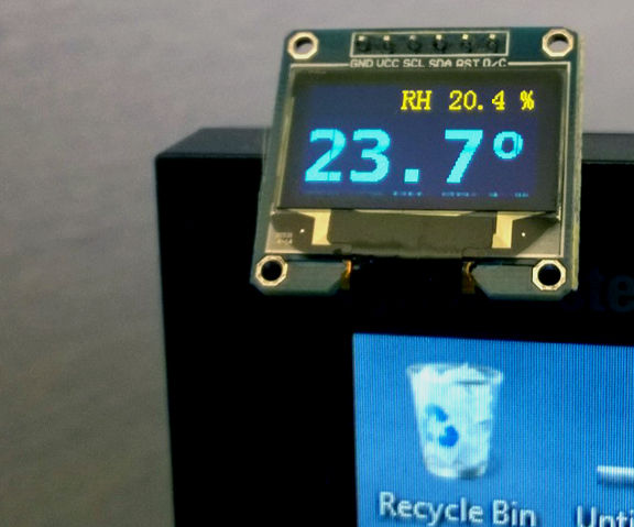

Step 1: Connect Arduino and OLED Display
OLED Arduino ------------- SDA D9 SCL D10 RST D13 D/C D11 VCC 5V GND GND
