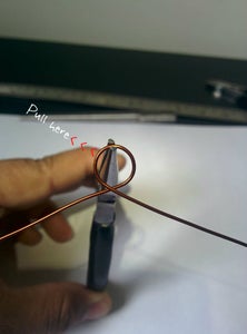

  3. Wrap the wire from middle around the mandrel's top (the thin part) or a pen like object, target to make a loop around 0.5 cm diameter.both ends of wire should intersect each other.
  4. Take out the wire from mandrel and hold the loop from middle using flat nose plier.
  5. Using your hand bend the wire from left by pulling it upwards, notice the heart shape is forming.
  6. Release the plier and pull both wires intersecting each other such that they form the heart shape.
  7. Use your finger to squeeze the heart , it you think it is bigger. This will also help to shape the heart properly.
  8. Using flat nose plier, bend the wires downwards from where they are intersecting such that they form legs of the heart , see image.

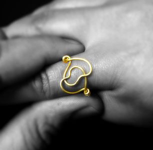

  6. Now insert the ring in the Mandrel to make a perfect curved ring for the size you have chosen. You can do this by gently pressing the hearts over mandrel thus they are curved.
NOTE: This step might require some practice
Now we have the bond of two loving heart ready , we just have to make sure that they are always together and intertwined :). In other words , let us see how to wrap the wire ends to secure the ring properly.
You may choose one of the patterns from the next two steps, both have their own beauty or whichever you find simpler to make :)
