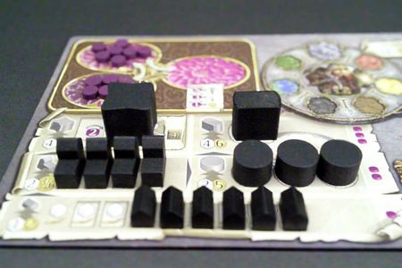

A missing game piece is the worst! Waiting for a replacement to be delivered or finding where your pet hid it can be time-consuming. Wouldn't you rather get back to playing?
Missing game pieces are a great use for 3D printers and a good way to learn 3D design, because the shapes are simple. In this instructable, I'll demonstrate the workflow involved in 3D design while making a replacement Sanctuary piece for Terra Mystica.

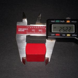

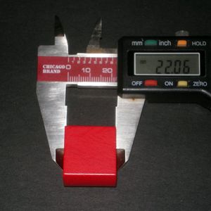

Electronic Calipers are the only tool I used for this project. They are available for about $20 online or in a hardware store. The can be used to measure outside width, gap width, or depth.

Use calipers to measure the dimensions of the piece you are reproducing. If what you're measuring isn't portable, you can store its dimensions in a measuring/sketching app. In this case, it is easiest to measure while at the computer.

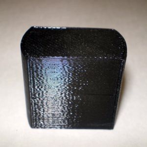

Step 6: Check Your Work
Looks good! They even weigh about the same.
A close look at the piece shows the lines of plastic that the 3D printer drew to create it. They can be sanded off with very fine sandpaper or smoothed using acetone.

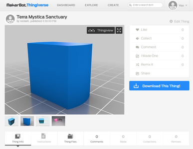

Step 7: Share Your Design
There are many places online where you can upload pictures and your .stl file for other people to use.
Follow this link for the file from this Instructable hosted by Autodesk with other, better 123D files from other users. I also uploaded it to Thingiverse.
