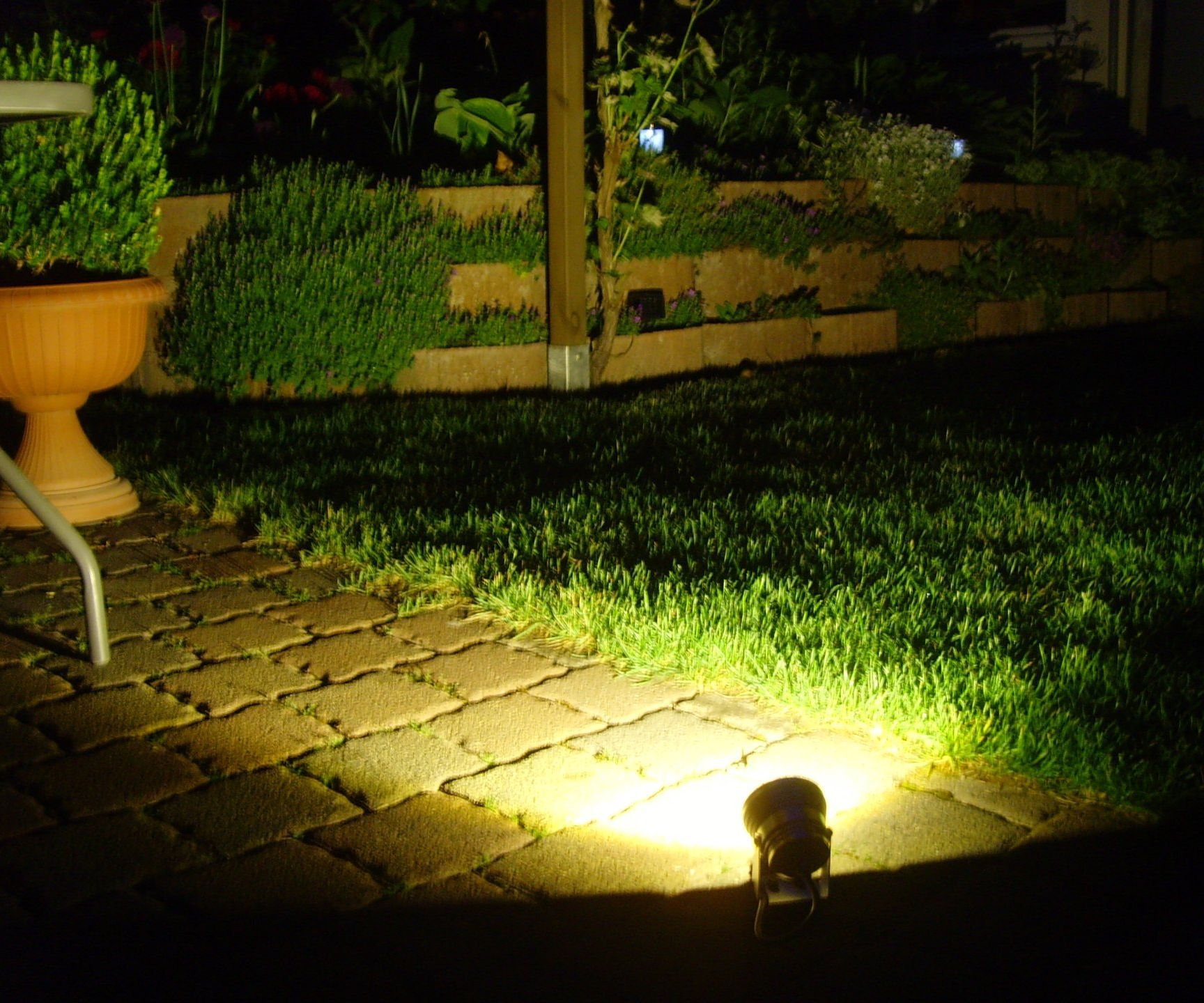

Introduction: Rechargeable Bike Light With Automatic Switch of Energy Source
First of all, excuse my non-native English and my lack of professional electrical engineering skills. I see this as a hobby and have no claim to be perfect. However, if you have some ideas on how to improve the setting don’t hesitate to write a comment ;-)
I haven’t seen any similar Instructable yet, which is why I quickly created one =)
My former bikelight was a pretty standard halogen light which was directly connected to the dynamo (generator) of the bike. Major problems I had with it were:
- Insufficient brightness
- Characteristics of the light beam caused by the reflector
- Light was not available when standing or at very low speed (disadvantageous at traffic-lights, junctions etc.)
My goals for the new bike light were:
- Rechargability via dynamo
- No need to exchange batteries
- Higher brightness
- Better distribution of the light beam
- Availability of light at all times (standing vs cycling)
- Low-cost
edit:
- quite similar project : Rechargeable Bike light set with bottle battery
- all pictures shot in battery mode (on dynamo it's approx. 1/4 brighter)

The LED is soldered to the designated cable pair coming out of the box. Furthermore, the reflector of the old bike light needs to be screwed off and the old blub needs to be removed so that the LED can fit into the mount. After that I hot-glued a LED-lens on top of the mount to focus the beam into a cone of approx. 60-90 degrees.
