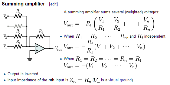

Step 5: Implement Summation
With the three filters, the amplitude modulator, and the 20x non-inverting amplifier designed, the final step is to connect the blocks together (as per the block diagram) and route the output of the low-pass filters into a summing amplifier.
