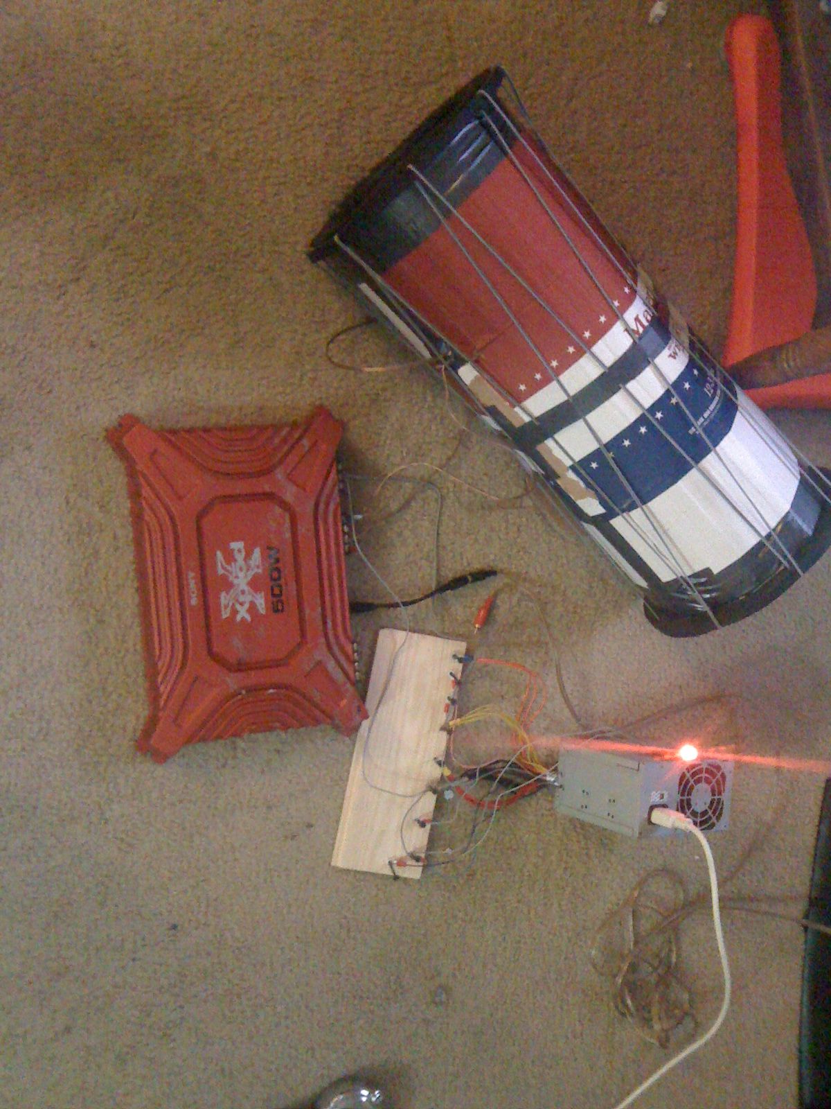

Step 3: Installing the PSU
There are quite a few guides on here on turning the PSU into a useable power supply. All you really need to know is the GREEN wire is the "ON switch", as it were, and all you have to do is connect it to the GROUND wires.
For our purposes I've take all the extra wires and twisted them up in groups to make them more out of the way. We only need 4 connections; the GND (black) of course, the + 12 Volt DC (yellow), the - 12 Volt DC (blue) and the GREEN wire. I choose to bundle them together to simulate a larger wire and allow some higher current draw with less heat per wire. (I made 2 GND terminals because I put one on the amp and the other on the switch.)
NOTE: Test your PSU. Tape down exposed wires and put a voltmeter on them to check that your PSU is working.
You'll notice I've placed terminals on all my connections because they fit the switch and the connectors for the AMP.
Now find a place to put it, cut a hole, tape it up, tape the crap outta that thing to keep it in place. I did not cut my hole big enough to push the PSU thru and I was okay with it since it matched the mounting for the AMP.
Be sure to not only tape it up so it won't fall but also so you won't push it in when putting in the plug. Get it taped into place all the way around, be sure to leave the vents as open as you can.
Once you've got it into place go ahead and hook up the AMP connections.

Step 5: The Reason for the Blue Wire?
I experimented for awhile and best I can tell is that you have to use the blue wire because it is the actual 0 Volt connection which means it's the only one that won't short the power suppler when connected to the green wire.
Electricity is weird, if you put a PC fan on the +5 and +12 connections instead of GND and +12 then you'll get the difference in voltage as your power, +7. So we can conclude the the GND or Negative (black) wires are actually +12 and the +12 (yellow) are actually +24. While this may be, the case is grounded on the black wires (i.e. anything connected to black could be connected to the case). Also, the -12 (blue) has very limited amperage available. The +12 (yellow) are the main and have the most current available.
Why does the -12 (blue) wire work then? The difference in voltage affect. What you are really connecting is 0 V (blue) to +12 (black). This means the current is flowing in reverse and that is why I tell you not to use a polarized lighted switch. Although you could easily swap the GND and -12V (blue) wire since when the switch flips it connects to both the other pins.

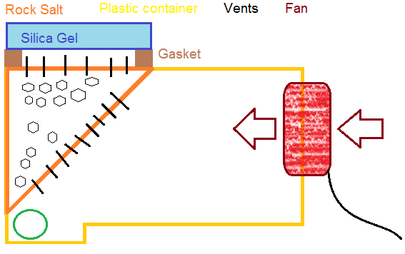

Step 6: Final Thoughts
Temperature issues? Read captions.
What would I change?
I would put in a connection for hooking it up to my car's power or to a battery for when I'm out & about.
I would suggest an LED to indicate power instead of a lighted switch. This could be on any other power/GND combination without being connected in some way to the GREEN wire and causing the PSU to short out.
A bigger box so I could section off the AMP & PSU and be able to seal the rest of the box. (A taller one at least.)
A box where I could mount both speakers up front.
A volume knob. My Blackberry on its lowest level is too loud to listen too when someone is sleeping in the apartment. I believe part of the problem is this AMP's high impedance input is not very high at all. When I turn up the volume on the phone it becomes fuzzy quickly, but if I turn up the gain knob on the AMP it doesn't get fuzzy.
A smaller fan for the PSU. The full size fan was unnecessary and may be contributing to power loss and noise.
If I had a bigger box I would've mounted a Zune and iPod dock on top plus an RCA connection.
I should have used my better power supply.
Yes. Painting your PSU limits the heat dissipation, but I don't think it'll be a problem.
I wanted to use an auto head unit (radio) but I don't have any extras of those and this amp was cheaper.
