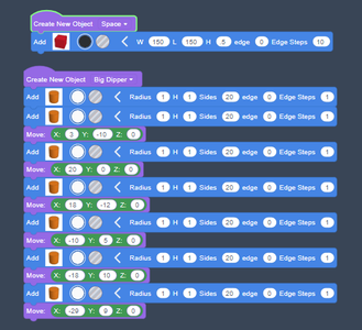

Step 1: Big Dipper and Little Dipper
  1. Create Background - Box with height of .5 and length and width of 100
  2. Create an object called "Big Dipper"
  3. Create 7 cylinders with the radius of 1 and height of 1
  4. Place cylinders (x,y) at the coordinates: (0,0), (3,-10), (20,0), (18,-12), (-10,5), (-18,10), (-29,9)

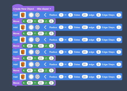

  5. Create an object called the "Little Dipper"
  6. Create 6 cylinders with the radius of 1 and height of 1
  7. Place cylinders (x,y) at the coordinates: (20,18), (13,20), (25,30), (28,23), (40,30), (55,20)

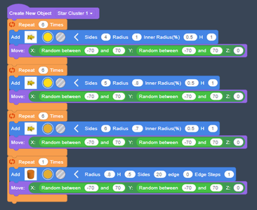

  8. Create Star Clusters (from Instructable 1) to fill up the rest of the space

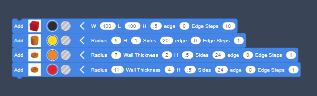

Step 2: Betelgeuse
  2. Create a cylinder with a radius of 5 and height of 1 - color yellow
  3. Create a tube with Radius of 7, wall thickness of 2, height of .5 - color orange
  4. Create a tube with the Radius of 11, wall thickness of 4, height of .5 - color red
  5. Create Star Clusters (from Instructable 1) to fill up the rest of the space

  4. Create Star Clusters (from Instructable 1) to fill up the rest of the space
