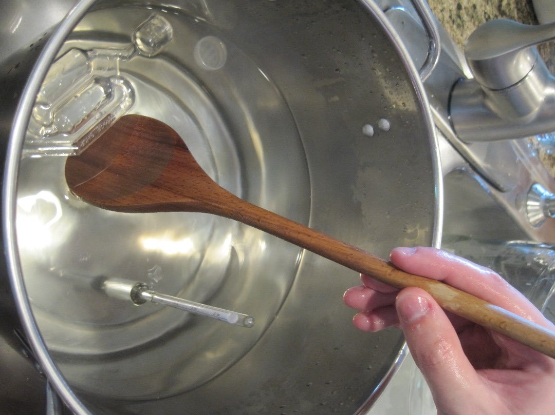

Step 2: Sanitize You Equipment
One of the most important steps in home brewing is cleaning your supplies. If you are not extremely thorough with the cleaning you may contaminate your brew with a multitude of debris, most notably, yeast. By cleaning, you are limiting the debris and more precisely controlling the fermenting process. During our brewing we used One Step which is, as the name implies a one step cleanser and sanitizer. Just mix it in to your kettle that you will be cooking your wort in and dip the rest of your supplies in to finish this step. Be sure to sanitize your carboy or fermenting bucket too!
